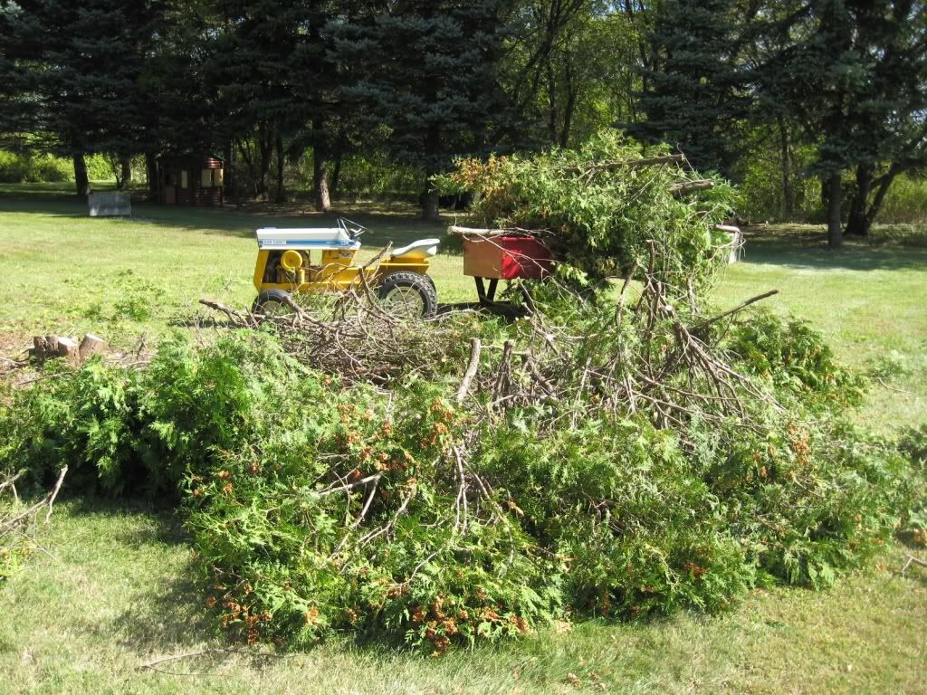

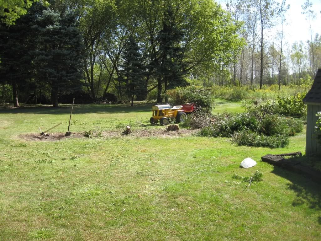

Had some fun with the 105
I cut down a row of 6 evergreen trees 15 ft tall.To make room for new garden next year. Haulin brush.

Nice load on the trailer :biggrin2.gif:
Beautiful area you have there :ThumbsUp:

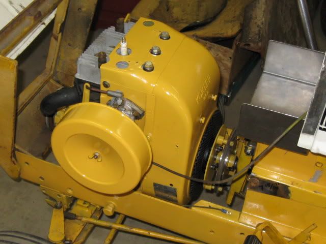

I did a quick spray bomb paint job on the K301 and got it back in the 126.

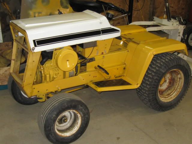

I also removed the mailbox letters someone had used on the hood. The black stripes are painted on. I may try to get some decals for it.

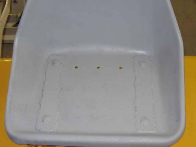

The seat pan was rusted and cracked so I sandblasted it and welded some pieces on to reinforce it. I welded on carriage bolts so there are studs on the bottom to attach it to the springs. It needs painted and recovered.

Nice work on the 126 :ThumbsUp:
