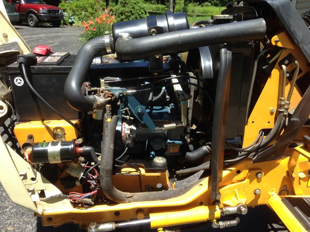

[IMG]http://i304.photobucket.com/albums/n...limini/011.jpg[/IMG]
Hey Sam, this is the foam tube I was talking about. Still trying to figure out how to post images.
Anyway, I had other problems with the new 2182 (pictured if it worked) so I didn't get to tinker with the heat issue. Got the throttle cable in, greased everything, changed oil, fired it up and pulled it out of the garage where she idled for maybe a minute, then died.
I struggled with this one. She seemed like she wasn't getting fuel. I could hear the pump running, but still spited and sputtered, but wouldn't stay running. Finally, I took the gas cap off. Tank was completely dry!!!! :bash2: Low fuel light was burnt out in the dash!!!! Check your light bulbs guys!!!!
