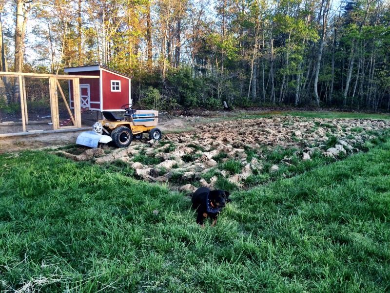

Picked up a new toy today. Model 1 tiller in good condition. PO lightly painted it white, so unfortunately the INTERNATIONAL sticker doesnt show itself like it should, but it's a solid tiller with no holes. He just didn't like the surface rust look it had. He also had the mounting bracket, gearbox, both belts, chains and lift pin. Hell he even gave my a sleeve hitch and lift arm (3pt). The gearbox and tines move freely and spin freely even after one twist of a hand. I need to get a mule drive now so I can hook the belts up and till my garden! Here's a pic yall might enjoy.

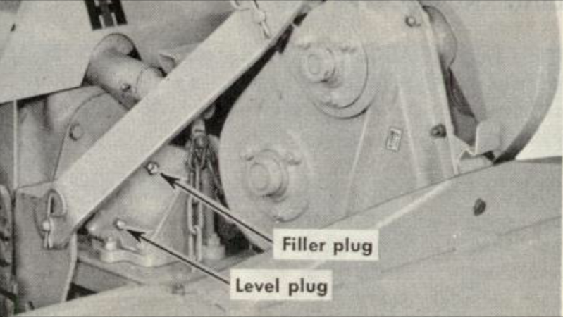

Does anyone see the level plug or filler plug? Here's a pic from the manual. The only 2 bolts I can see that might be what I'm looking for would be the 2 mounting bolts for the plate with the IH logo on it. Kinda looks like a #2 gearbox if you ask me. If that's the case, I know it's a sealed unit.

Jeff in Pa 04-29-2015 09:31 PM
You don't have that style cover so the only way to check fluid level is to remove the cover.
You can either remove the mount or gear box OR park on hill / block up the one side of the tractor.
