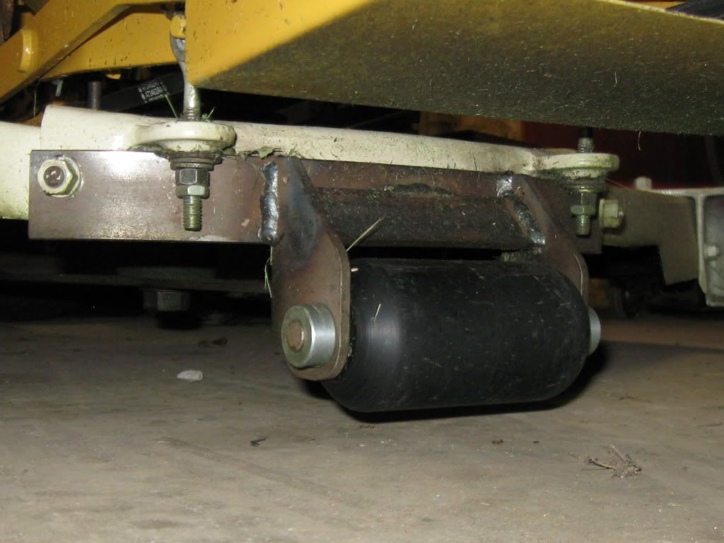

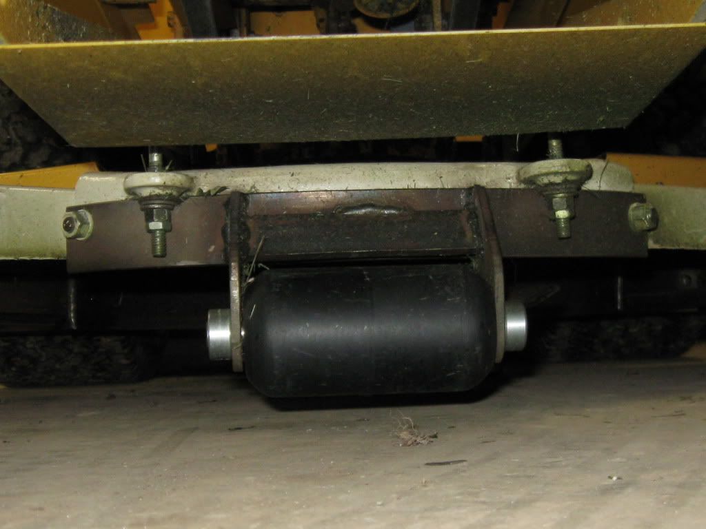

I added a front center roller to my cast end deck to keep from scalping my yard. It made a big difference. No more bald spots in my yard. I made the roller out of plastic and the mount is 3/16" steel.
http://i934.photobucket.com/albums/a.../roller003.jpg
http://i934.photobucket.com/albums/a...Cadet/roll.jpg

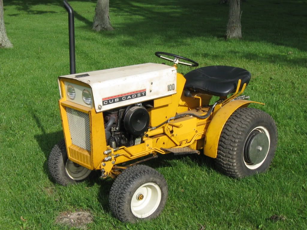

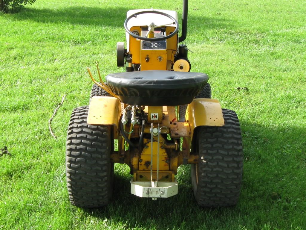

Swapped the chained tires for my 23x9.50 Sears tires.
http://i934.photobucket.com/albums/a.../roller004.jpg
http://i934.photobucket.com/albums/a.../roller005.jpg
