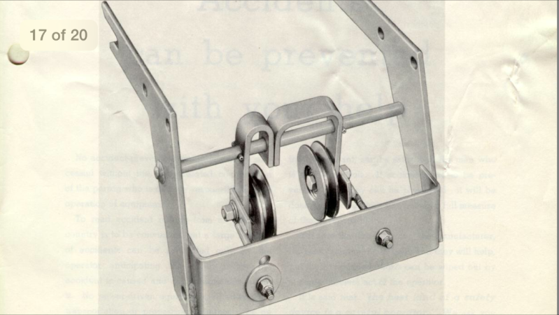

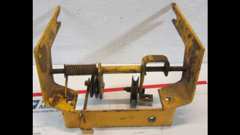

Does my mule drive have to look identical to the picture in the manual? It looks quite a bit different then the one I have. I know you have to remove the extension spring, but it looks like the bracket on the right needs to be turned around, and the one of the left doesn't even look close to what the bracket looks like I'm I the manual.

I got the mule drive, disassembled it, straightened the pulley brackets, replaced the pulleys and put the mule drive back together. The belt that came with the tiller is too long. I'd say it's about a foot long. I used a rope to measure the correct length needed. I figured since the 2 mule drives in my last post are so different, i will just leave the tensioner alone on mine and just replace the tensioner bolt on the one side. I'm sure everyone enjoys reading my posts.. Lets see if I can get some good informative replies from somebody.
64fleetside 05-02-2015 03:03 PM
I used a 44a mule drive as it was what was on hand. Straightened the arms, used a couple new pulleys. I ended up ditching the spring, welding both pulley brackets/tubes into one assembly after figgering out how I wanted them to line up. This allowed use of one adjustment bolt. Seems like I turned one around, then I drilled a new cotter pin hole to keep it located side to side on the shaft. I used a Gates AX144 belt.

Belt didn't get tight enough with the spring, that's when I ditched it and welded both sides to tighten as one unit. Didn't have time to buy or make another adjuster, had to till!
