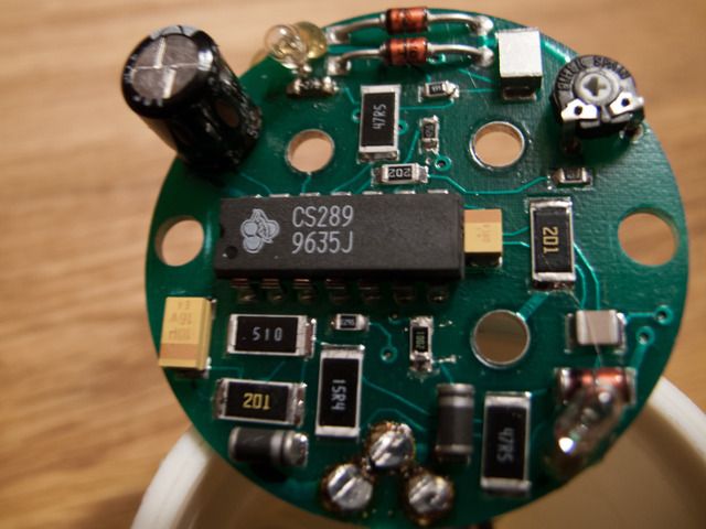

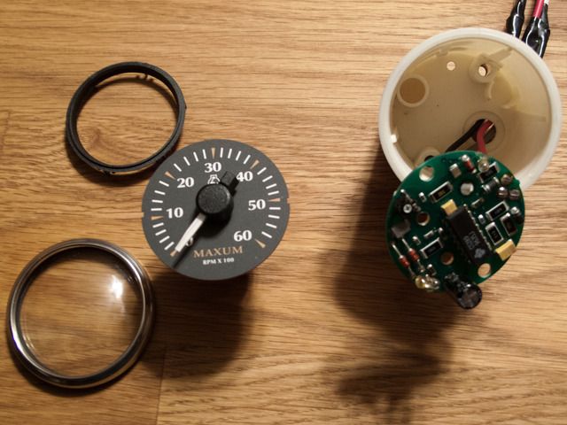

The simple (stupid) way was not accurate so I decided to crack the belly of the Faria meter.
http://i1096.photobucket.com/albums/...aria%20RPM.jpg
Here you can see the heart of the beast, a crappy Chinese RPM driver (Frequency to voltage converter) made by Cherry Semiconductor. (CS289-9635J)
http://i1096.photobucket.com/albums/...loux/Heart.jpg
Now all I need to do is study this circuit and lower the voltage send to the meter coil, simple enough? We will see :coffee:

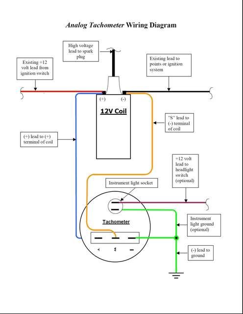

I got the parts I need to mod mine, I just need spare time to give it a try. In the mid time I found Kirk installation pdf file, he take his signal from the ignition coil instead of the stator/generator.
http://i1096.photobucket.com/albums/...Kirk%20RPM.jpg
