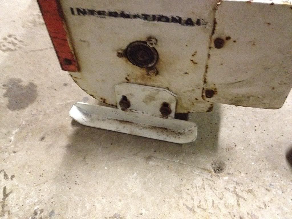

Sad because I just fabbed up a snazzy new pair of shoes for her.

The new "shoes" I fabbed up for it, are a little taller than the OEM ones. It added rubber "flaps" to replace the scraper blade. (the blade is still there, it's just holding the rubber in place.) The rubber flaps are too long, and the shoes too tall. If I was going to continue using it, I would lower it another inch, but the slots in the shoes would need to be opened up. This time of year, some of the sections of concrete in my driveway heave and the "scrapper" bar was getting caught on them.

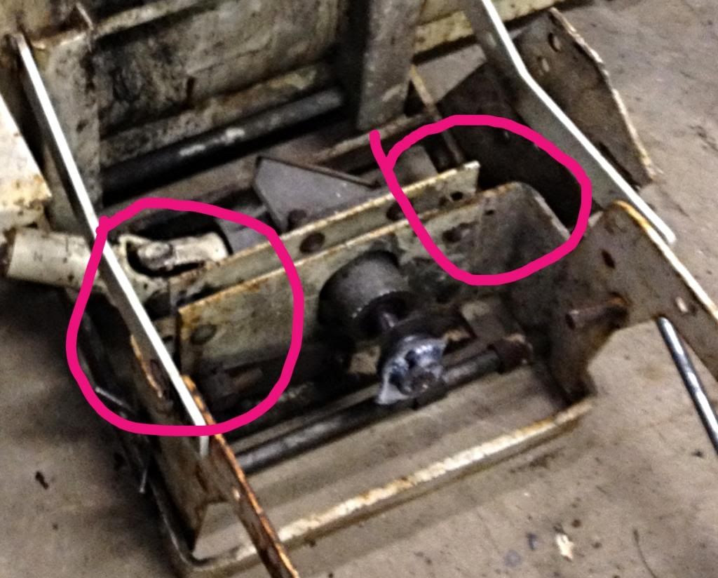

Kind of a blurry picture, but inside of the pink areas, you can see how the plates that hold it on the tractor, are adjustable in width.

That picture reminds me, it also has the curved lift arms, for a 782 tractor. As seen here;
http://ccspecialties.org/implementparts_1.html
The 4th item down that page. I no longer have the striaght arms, for the narrow frame tractors. I replaced them, with these, pretty sure the old ones were hauled off.
