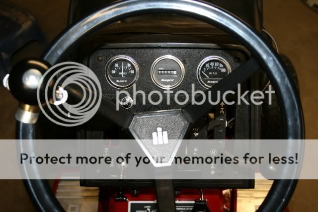

aagitch 09-19-2011 09:31 PM
I also like having an oil pressure gauge to look at. I don't know much about the insides of these engines but hopefully maybe it's rebuildable.
http://i590.photobucket.com/albums/s...ges640x427.jpg
