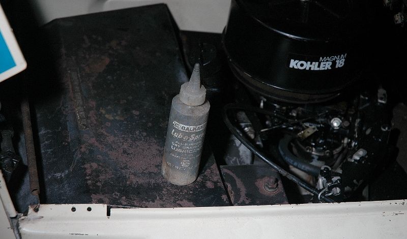

Well, the 1872 has never really started right for the last couple years.
I have posted about it before, and I was recommended to take the starter out and etc............... :bigthink:
Well I never wanted to get the starter out, I tried
bigger battery cables,
cleaning the grounds,
installing a 390 amp battery.
Everything helped a little, but, none were the "Big Fix"!!
It is springtime, I need the 1872 and didn't want to tear it apart.
I figure I would try one more band-aid!!
I took off the left engine cover and just "poofed" some of this on the exposed end of the starter.
http://i1104.photobucket.com/albums/...010800x470.jpg
I bought it at NAPA 20 years ago, don't know if it is still available.
Well, the results were more than shocking!!
The 1872 starts so fast now, I let go of the switch as soon as I hear the starter make a sound. The 1872 is running!! First time, every time!!
Amazing what a poof can do!! :bigeyes:

Ha! Glad that's what the pic was. I was expecting to see a photo of a burnt wiring harness and melted starter lugs! A little dry lube goes a long way. My buddy's 1450 (whose starter is far more accessible) was having issues with the bendix not kicking out; he took it apart and lubed it and has not had anymore problems with it for over a year now. :beerchug:

I tryed some "chain wax" dry lube for dirt bike mo'sikkles.
So far it stopped that annoying noise.
With a little application tube provided, it was a easy application.
I'll will see how long it lasts---
