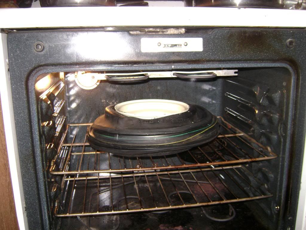

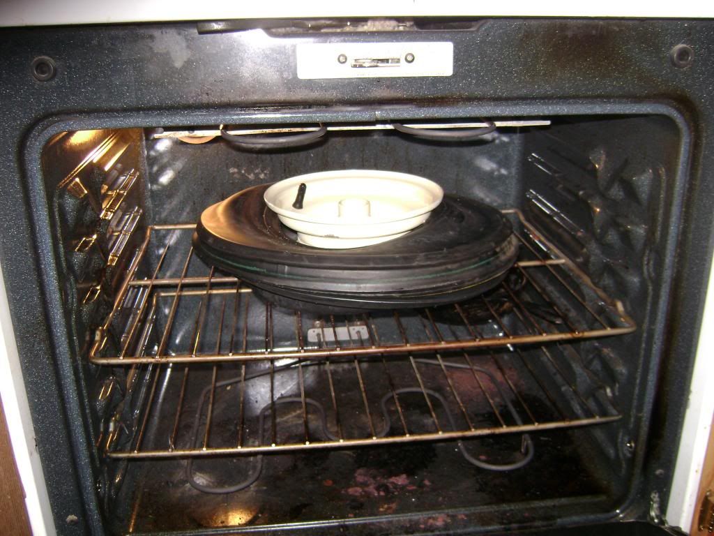

:biggrin2: UPS delivered my tri ribs for the 128 at about 6pm. It didn't take long to get them on the rims, but they were so disfigured I could not for the life of me, get them to open wide enough to seat, so, I set the oven to 180 and cooked the first one for about 30 minutes flipping it a couple of times. Was able to get the ratchet strap to spread the tire enough to seal while I put air in it. One done, cooking #2 right now. :beerchug:
Will get some pics of them on the 128 tomorrow.

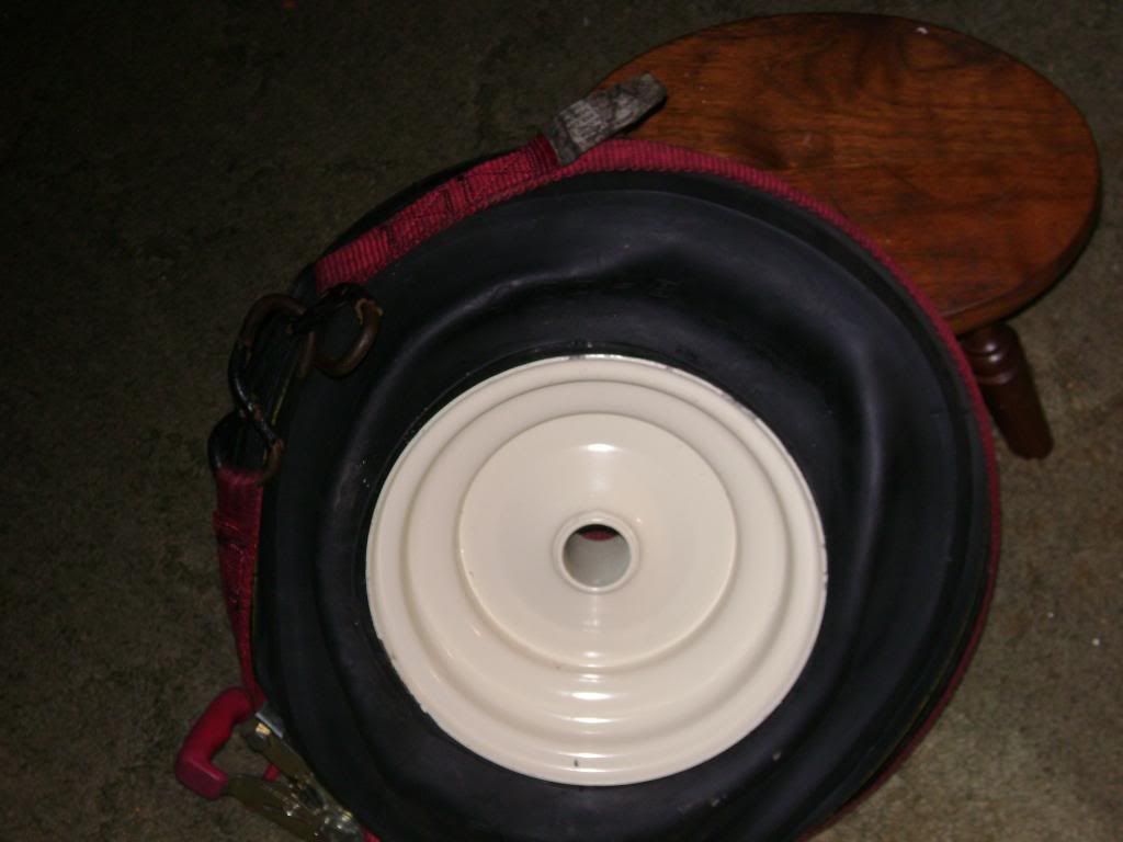

_DX3_ 10-15-2013 08:44 PM
I decided to smoke em, LOL.
It's just starting to get nice and warm and pliable.
I'll get a pic with the ratchet in a little while.
http://i210.photobucket.com/albums/b...ps47e71428.jpg

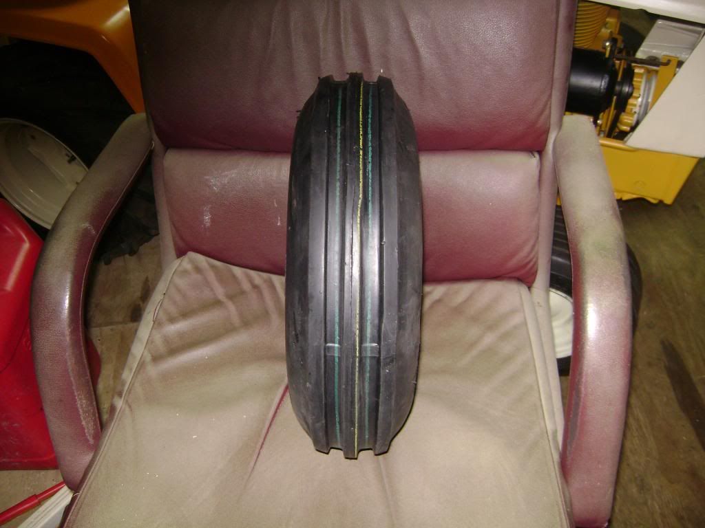

_DX3_ 10-15-2013 09:25 PM
Originally Posted by Merk (Post 221380)
All my tri ribs say to use inner tubes on the side of the tire.
I hate to hear that, these are tubeless. :biggrin2:
http://i210.photobucket.com/albums/b...ps45915d40.jpg

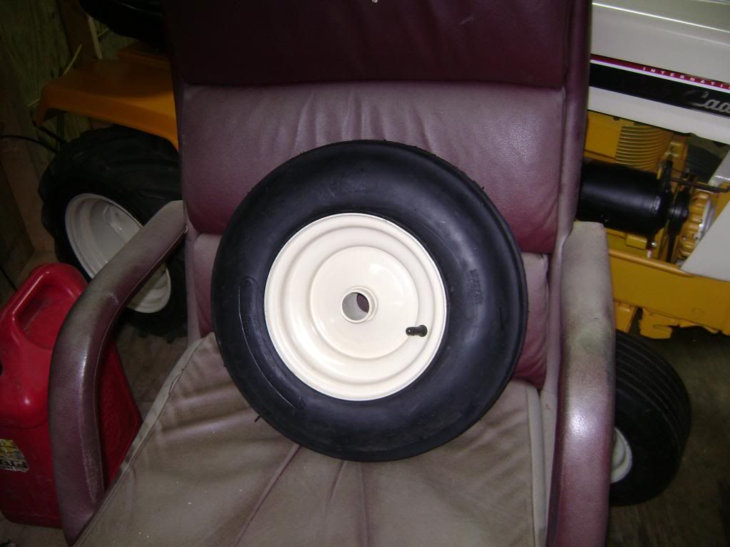

Final pics:
You can see how the bead pulled up to the rim.
http://i210.photobucket.com/albums/b...psf5930601.jpg
Pulled down to spread bead to seal with ratchet.
http://i210.photobucket.com/albums/b...ps3b38b77b.jpg
Tire seated and filled with air.
http://i210.photobucket.com/albums/b...psa01e7eab.jpg
http://i210.photobucket.com/albums/b...psc2ccb124.jpg
