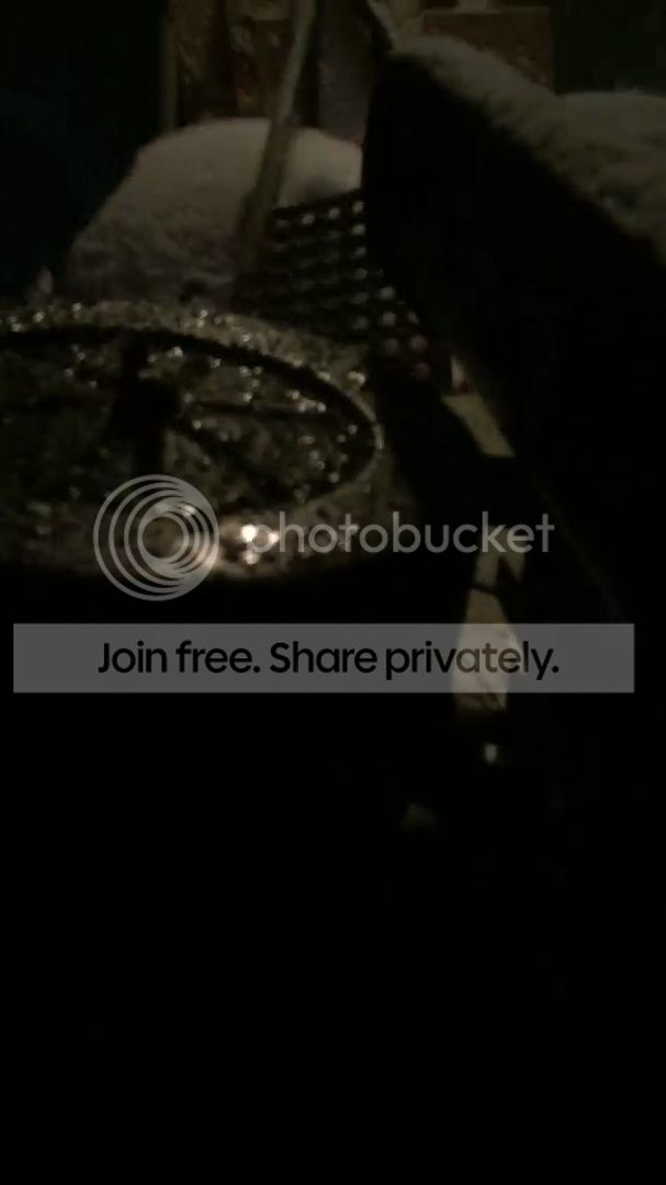

Trying to get a couple videos uploaded. Not going that well, but here is one. Given its always dark when I get home (and 15 degrees out), its tough to see. I tried aiming the timing light at the carburetor - you can see the throttle pull open then a fairly slow delay until the governor catches up.
I did check the plugs and they are clean, and a little light gray. I put an inductive timing light on them and both seem to be triggering the electrical pulse.
The fuel is fresh. Letting it warm up shows no improvement.
I wouldnt mind changing out the sparkplugs. But now thinking its fuel related. Or governor?
Also it seemed to get worse when a load applied (like pushing a big pile of snow).
I will try to get the other video up and going. Not sure you can tell much from these.
http://vid708.photobucket.com/albums...astick/064.mp4

jeepchicken5000 02-03-2015 11:20 AM
since its an M18 and has a magneto, it also has a magneto kill switch wire correct ? lets say the kill wire was grounding out on the engine somewhere cause a weak spark or no spark since it is doing what its doing, have had that happen to a couple briggs vtwins and they ran like crap, id say its within that ignition module your problem is. also make sure your key switch isn't all rusty and dirty ive had them cause all kinds of problems and a new one will do wonders.
Billy-O 02-03-2015 11:56 AM
I'm leaning towards electrical. Do you have this problem in DRY conditions? With it snowing out there, snow is getting blown around motor and perhaps creating conditions just right to short out here and there.... like on older spark plug wires or bad insulation. Just a thought.
