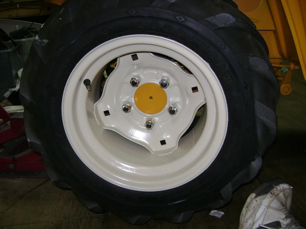

_DX3_ 06-26-2015 12:19 PM
Get a stud lug nut kit. Makes putting rims on so much easier, especially if they are filled.
http://i210.photobucket.com/albums/b...ps7ace7149.jpg

Ha, I did the exact same thing, but did not know they had a kit, LOL. You go get 10- grade eight 7/16 National fine 20 threads per inch bolts 1.5 inches long and screw them in the backside and then you can use chrome acorn mag wheel lug nuts. That how I did mine, works great. Threw a pair of Cragar 3 -1/16 push thru center caps on and it looks sweet. Best mod I ever did for under45 bucks. (bolts $6 MacMaster Carr, triple chrome acorns Ebay 12dollars, Cragar caps Summit Racing 2 for $25)
