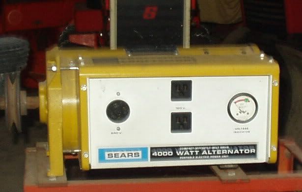

My Son and I built this 8 years ago.
http://i152.photobucket.com/albums/s...ents/gen08.jpg
http://i152.photobucket.com/albums/s...ments/gen8.jpg
It's only 4000 watt alternator that I pick up at an auction for $50.
http://i152.photobucket.com/albums/s...ments/gen1.jpg
View from the left side:
http://i152.photobucket.com/albums/s...ents/gen28.jpg
I used a mule drive as the mounting bracket to the tractor. The modified mule drive goes on first. The mount that holds the alternator is slid in the square tube on the modified mule drive.

I like it. 4000 watts is plenty for most work. I guess that's the key, re purpose existing/used parts to bring the cost down. Like this;
