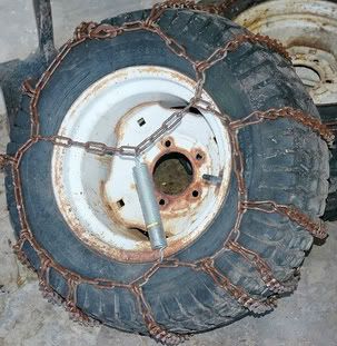

I have heard the deflate-inflate method. I do not want to be deflating-inflating when the snow is flying and the chains shift and become looser.
The rubber car binders are too big and dry rot in a couple years.
I like steel!
That spring is extended about 1/2".
The chain is a piece left over after I cut the chains to fit the 23x10.50's.
As the chains shift during use, the slack will be taken up.
Did I miss anything??
I will slap these on the QL1000 when the snow flies!!
