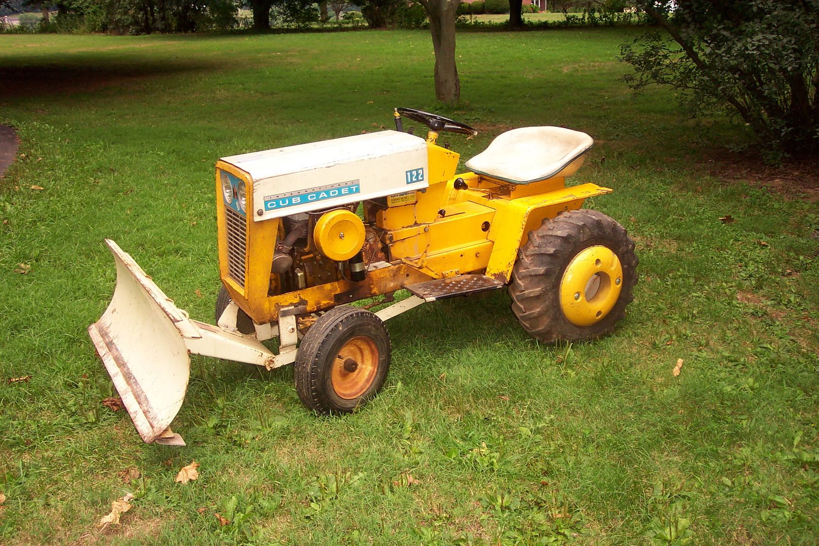

I was asked to show how I mounted a QA-42 to my 122 ( which does not have the quick attach ears ).
It simply bolts up the same way although the quick attach points aren't used. The metal plate ( as seen in the picture ) has a 1/2" pin that goes into the through hole and is held in place by a 1/2-13NC bolt that bolts to the factory welded nut.
If you don't have the same plate, another 1/2-13NC bolt with washer , lock washer and nut is used. I find it much easier to put the bolt through from the inside and places the washers & nut on the outside. I put a long flat screwdriver against the head when tightening and that seems to work for me.
Here's the QA-42 on my 122
The exact same hook up works with the quick attach 42" front blade too although only the forward hole is used. Bolted in this picture.
Fancy pin plate with washers to space it out on this picture.

i also had to improvise to make my QA36a quick de-tach from my #109 to fit my # 122.
After grinding off the quick detach bolts from the snow thrower I also used the existing holes to bolt on the frame of the # 122,
Since then I purchased a quick re-lease bracket for a narrow frame & convert back over so that the snow thrower will fit both the #109 & #122,
