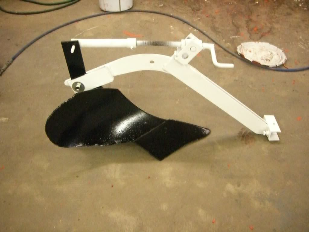

I made a plow for my cub. Why? Because these are not available here in Finland and importing one used plow from US would of costed about 500 USD. And I needed it yesterday not in august I used old plow from big tractor as part donor and pics(Disc is missing in pic I have not put it back yet after painting):

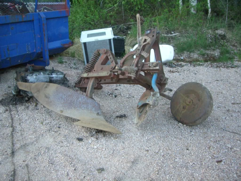

And part donor(was in my friend scrap iron pile):
Tero

Looks awesome!
Don Smith
Old 05-27-2012, 04:01 PM
That looks great!!
Don't be in a big rush to put the coulter disc back on.
The coulter is seldom needed, and it holds the plow out of the ground.
Try the plow without the coulter disc first, see how it works.
If you look at the donor picture, notice how much more steel and iron there is to give weight to push the coulter into the ground.
We love the pics. I hope you post some action pics.

by CADplans
I use a coulter all the time. It will help with the furrow wall if the plow is set right.

I hate to be a party pooper but I think that setup will give more grief than smiles.
Why?
The hitch point is not off set/angled as like a Brinly moldboard plow is, so unless the sleeve hitch is bent the plow will not sit flat in the furrow.
Simple fix if you can figure out the proper angle to reweld the hitch point at.
Sorry I have no way to measure the poper angle.
Old 05-31-2012, 08:52 AM
WinterHawk77 WinterHawk77 is offline
Location: Rhode Island
Posts: 15
Terkaa, Good job and great ingenuity. I just picked up a Brinly yesterday and was able to measure the angle for you. The hitch is 14 degrees off vertical. Measured with a table saw miter gauge from the frame to hitch. Good luck turning some soil.

Hi,
My hitch is also DIY. So I can adjust it(it has few set of mounting holes) But it is good to know correct angle so I dont have to guess correct angle for plow.
