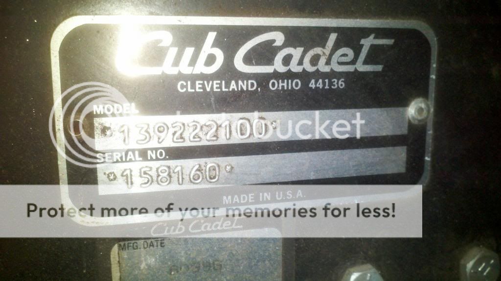

Here is the model number. This is what the dealer used to order the parts when I had them look at it. When the parts came in they were way off, that is why Im thinking this transmission may not belong to the mower

Looking at the pics again your trans case does not look the same as mine or either case in the service manual. Does the axle have flats on it (D type) where the wheel hub mounts or is it a key shaft? I am thinking this is not the correct trans axle. The bevel gear looks like it was skipping and you may be able to shim it with a thin washer to engage the other gear better but I would replace it if you can find out the part#. Many parts on peerless transaxles interchange with similer models. I would suggest you watch some youtube videos on working on them lots of good info there. and some guys even race them.
