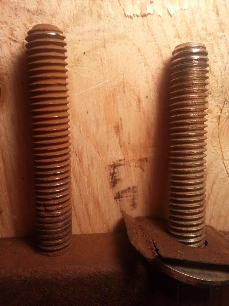

I have the manual and I've read that it's left handed in another thread but the original adjuster I have is definitely not left handed. Is it possible the guy that sold it to me just threw one on from a different model that is right handed thread? Original on the left, mangled replacement on the right:

Is the adjuster supposed to look like this?
that IS reverse thread and that castle nut makes sense because there is a hole for it which is not the case with the adjuster I have. I'm starting to think I got a little hosed on this snow thrower from craigslist. The belt I was given was too big, the lifting rod was too short. now this...
Yes, that is the same as the adjuster on my QA-42. It is left hand thread.
I can make them if there is a need for them. Anyone have an extra one I can get dimensions from? ( I'm not pulling mine about in the middle of winter)
I appreciate it but Im just gonna double check its indeed left hand threaded and bring it to work. We have a machine shop there with welders and much more capable people than I to make something up for me.
If anyone with a bottom adjusting thrower could post pics I'd appreciate it.
I'll see if I can get pics tomorrow. It is a left handed thread. Hold a regular bolt to your screen and you will see the thread goes the opposite way.
As far your comment I bolded, that's me. A machinist with extensive fabricating and welding experience during my 35+ years in the trade.
Thanks Jeff. I can definitely see the one in the pic I posted as being left hand threaded and the one that came with my thrower being right hand threaded. I just want to make sure that the adjuster for a side adjusting blower(which is the only one I can find pics of) is the same as one for the bottom.
