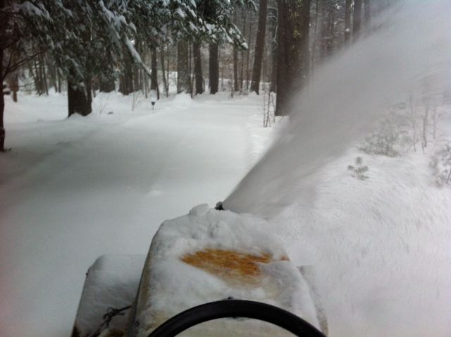

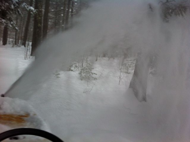

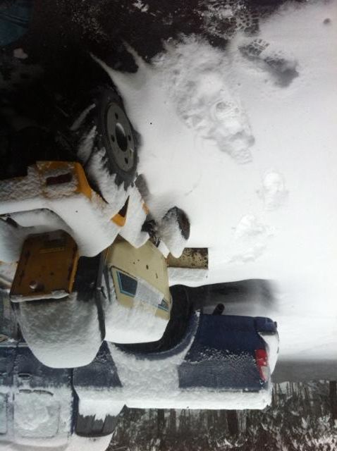

Drug (I know, 'dragged') this 1811 home earlier this week. It has a two stage blower on it. About 1000 hours. Either a switch or a solenoid (or wire) to get it to start with the ignition but jumping the solenoid starts easily. Was able to get it out this morning in the snow and a couple observations.
Less than an hour run time but the engine is smoothing out already. I think it set most of the year (only used it for snow, and the PO bought a replacement last year). Some fresh gas and running it a bit seems to be helping.
Hood and side panels have some surface rust but just barely through the paint and in quite good condition for a refinish.
This blower is heavy. 'Too much' for the tractor in some ways. I wish it lifted higher, and when down the front tires wont bite enough to turn it tightly (at least sometimes). Any little bump or incline transition and the tractor struggles to move it.
Having said that, for up and down swipes on the drive it blows like crazy. For deeper snow, no comparison to the blade. So even if I sell the tractor, think I will hold onto the blower (assuming it fits the 784 as well). But I need more time with the 784 first to learn more how then engine on it will hold up - seeming to be burning a little oil to me, and oil drips means I need to dig into it a bit and learn more. In the mean time will just clear the drive with this 1811.
And yes these set out overnight because I wanted them near the house for duty first thing this morning.
Still snowing so I get another round this evening.

Nice 1811 and blower! Thanks for the action shots.

Get some weights on that thing! I've got filled tires, chains, and a set ofnIH Weights and nothing stops the thing. Good looking machine, glad your enjoying your new toy!

Yes, the blower is heavy, you need 30psi in the front tires to carry it. No, you can't steer with it down, you have to lift it a little. If you can't push it, you need service the hydrostat on the tractor, it should push it fine. No, they don't lift very high, just they way they are. Good luck!

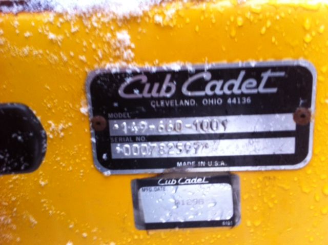

Nice 1811 and blower combo. Should be a 450. It should work on the 782 as well. I'd love to find one for one of the smokers......

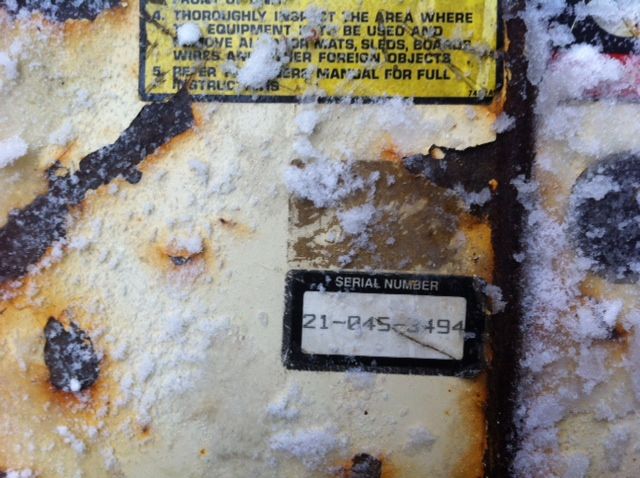

Im not sure the blower model - the tag is missing. Did happen to snap one of the serial number tag, if that helps:

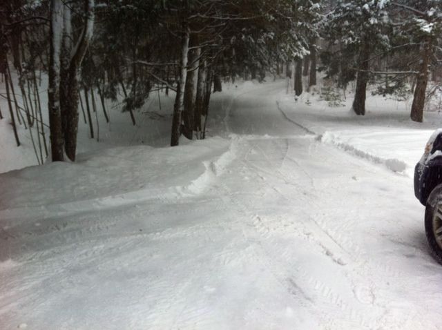

This was about 6", and by the time I get home tonight should be another 6" of fresh snow. So more practice time.
Doesnt look that deep in this finished pic:

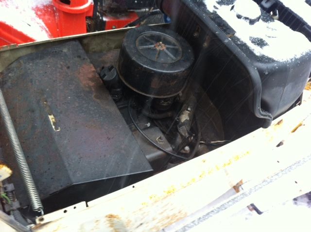

Belt broke.
Pretty torn up so not exactly sure the size (doesnt piece back together so cleanly). Anyone know what size belt to connect a 450 (?) blower to an 1811?
