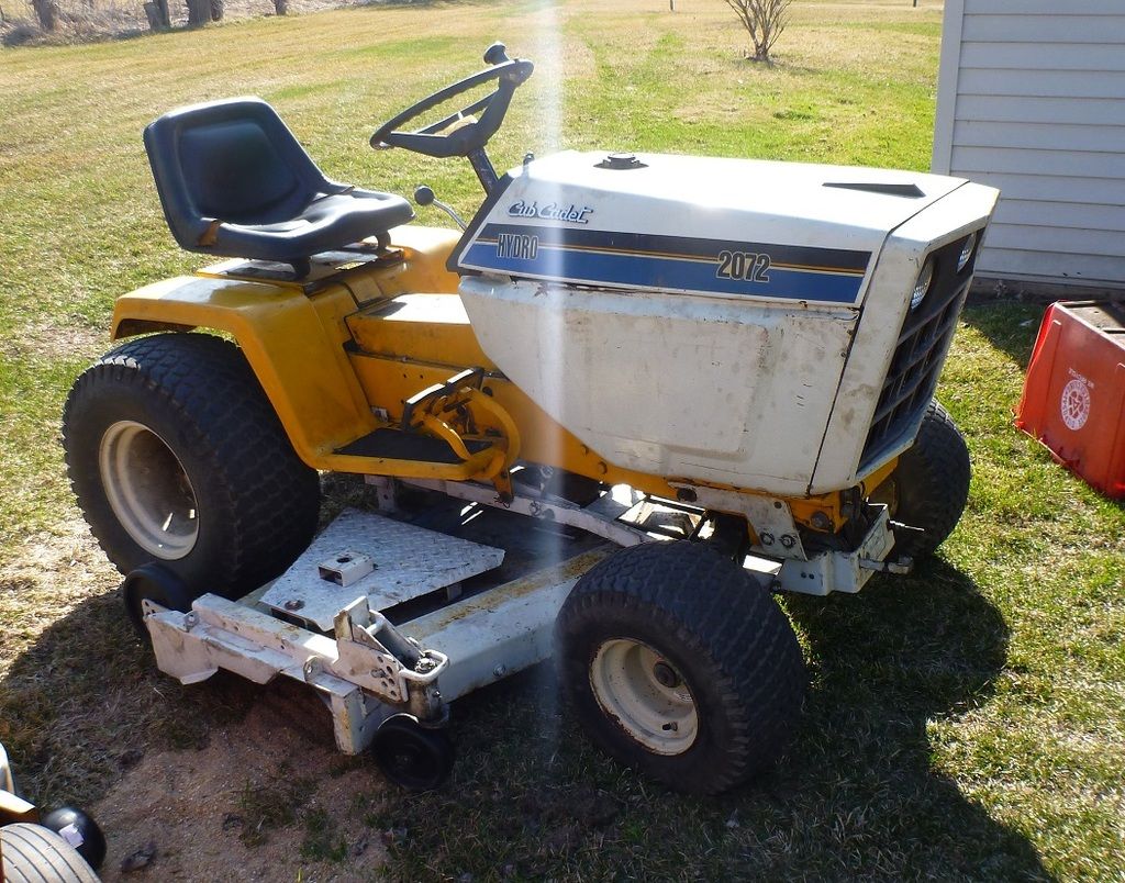

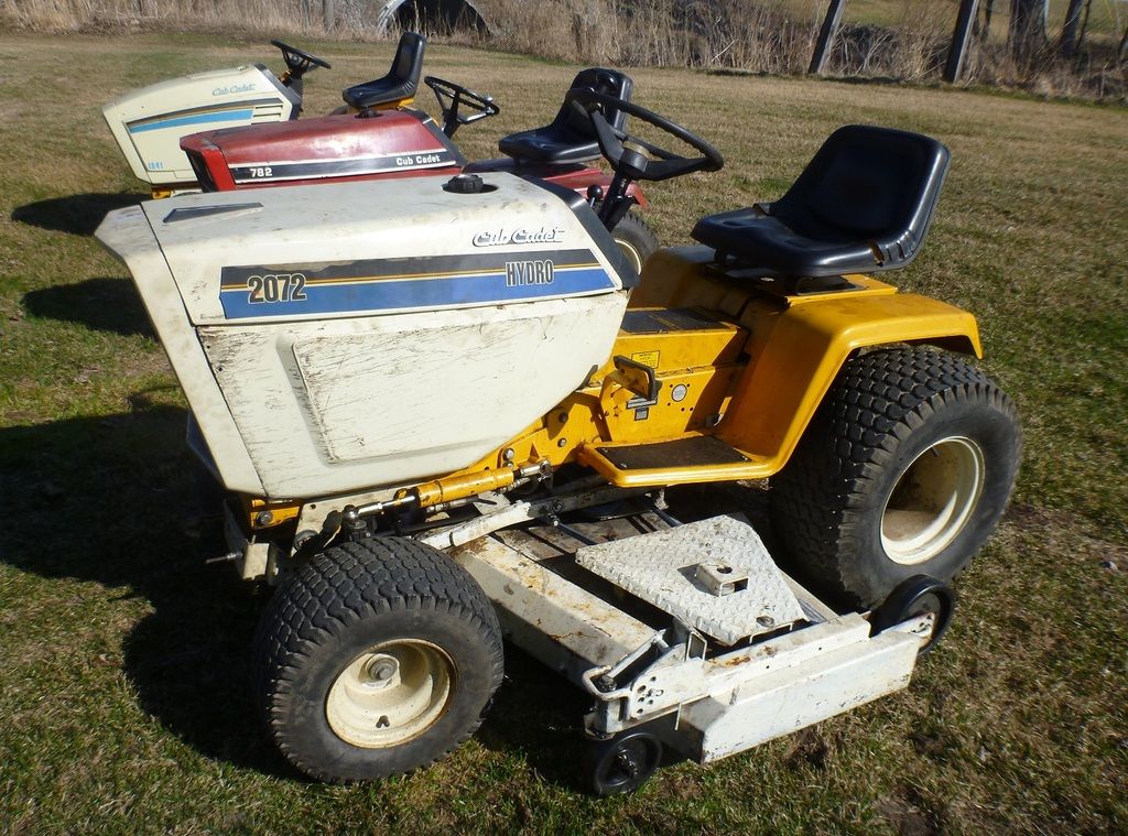

I've been browsing this site and researching since I got my 782 a couple years back. That turned out to be an excellent lawn tractor which, of course, led my acquisition of this 2072.
Didn't take long to discover the rear end problems these tractors are known for. I had to pull the axle housings to helicoil all 4 upper frame mount holes. My front trans mounts are all intact with good threads even, but all the bolts were long gone. Just have a slow drip at a couple lower bolt holes. I'll address that when my braces arrive from xtreme.
The power steering unit popped the upper seal when I was examining it with the seller--got a few bucks knocked off for that. I went thru the column and replaced all the seals and o-rings. Picked up all new ball joints and rod ends.
While the Kohler M20 was out, I freshened the valves and rings, new seals, and found an fully adjustable Kohler carb to replace the lousy Walbro.
The 60" Haban was pretty nice. Needed new wheels, but the spindles were perfect.
Still needs some work--align the front end, braces, the mule drive hanger is bent all to heck and ruining the belt.
I did a small test mow out back and it isn't disappointing so far.
Can't wait to try this thing out, but it sure needs a bath.

The 782 is staying to use near my house--there are places the 50" will barely pass, to say nothing of using the 60". I pulled the KT17 series II a couple months ago and had a local machine install new guides and hone the bores. This engine went from being a pain to start to being nearly effortless. Seems quite a bit more aggressive as well. Can't wait to try it.
The 1541 is not staying with me. I bought it cheap for the very nice 50C deck to put on the 782. Not liking to waste stuff, I decided my dad needed a new mower. The 1541 will get my old, but servicable deck off the 782 with new bearings. Plastics on that thing are, of course, beat to heck. My dad won't care. He is liking the idea of the hydro trans and lift. Plus, all the interlocks still work to my great annoyance.
