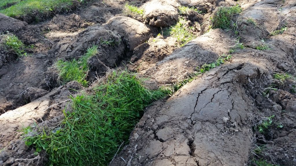

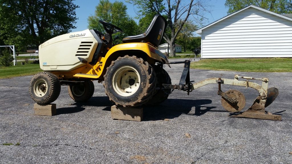

Here are some pics I just took, it was plowed yesterday so it's dried some. You can see the thickness of the grass in the background. I'm not very impressed with the results.

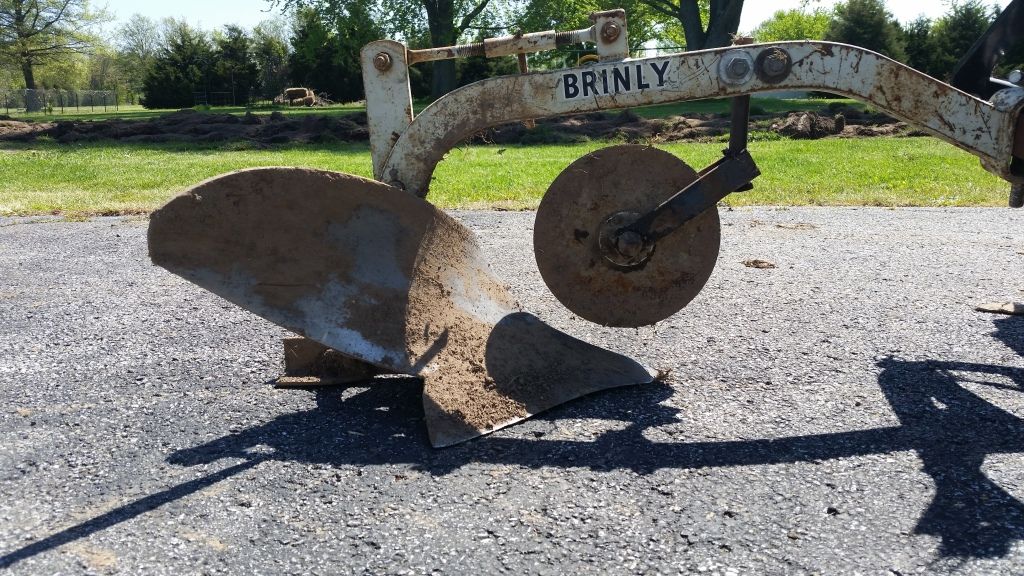

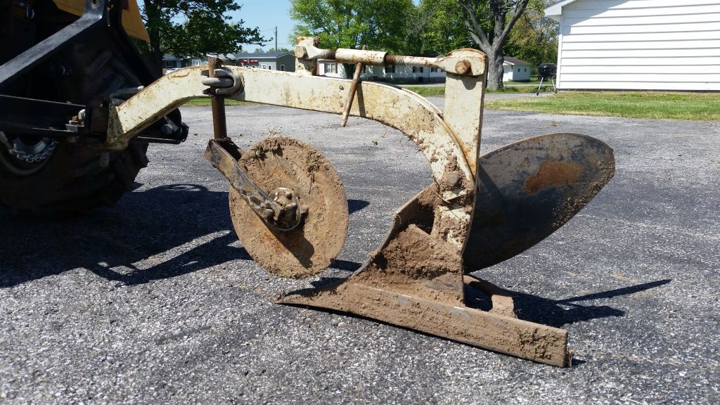

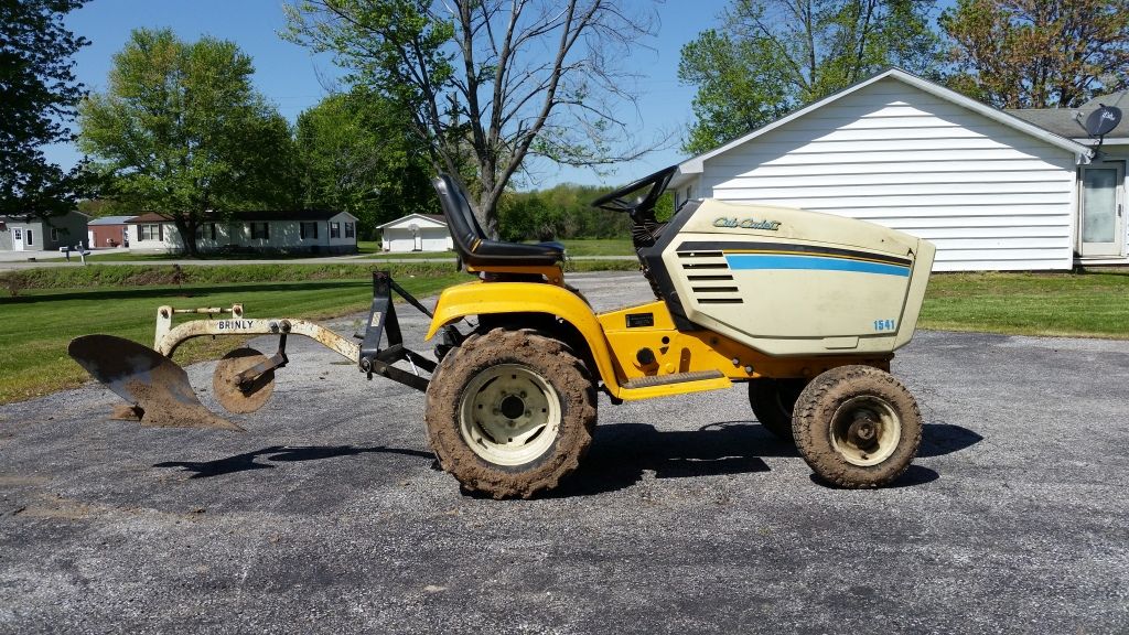

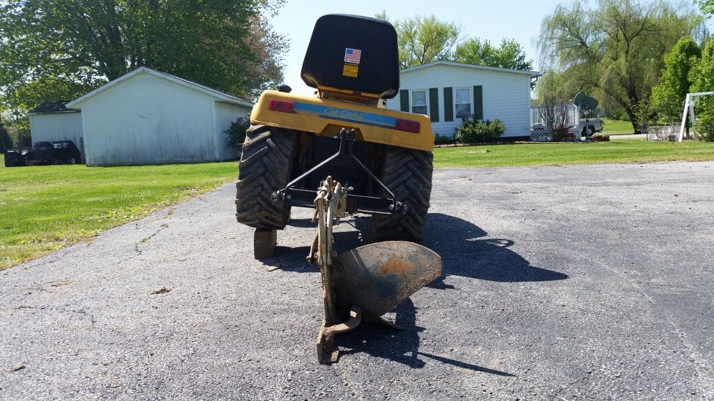

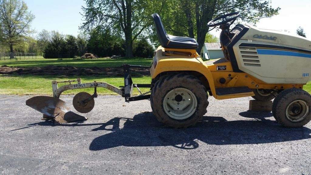

How about pictures of your Tractor and Plow setup..???
I've got them uploading

Looks like it was a little too wet.

You turned a grassy area in to dirt!
Here's my take on your plowing job.
1st - Plowing sod, grass, etc. Toughest plowing there is. Whether its with a 100hp tractor and a 4 bottom semi mounted plow or a Cub Cadet with a Brinly. I've seen worse plowing by farmers who had plowed every year - I've done worse too.
2nd - see #1
3rd - your set up looks maybe a bit more point on the plow, the landslide seems to be right on the ground, in a perfect world you should be able to put your fingers under it in a furrow. But you turned sod into a plowed area so you doing it right or really close.
4th - SHINE SHINE SHINE - a shiny plow works best, nothing beats a shiny plow. After your done plowing clean it, then oil it or grease it or something, preserve the shine for next time. Of course that next time is probably when you plow this same area, which will be easier due to it then not being sod.

Next you get to disk this breaking up the clumps smoothening it off. best to wait a few days before you disk.
