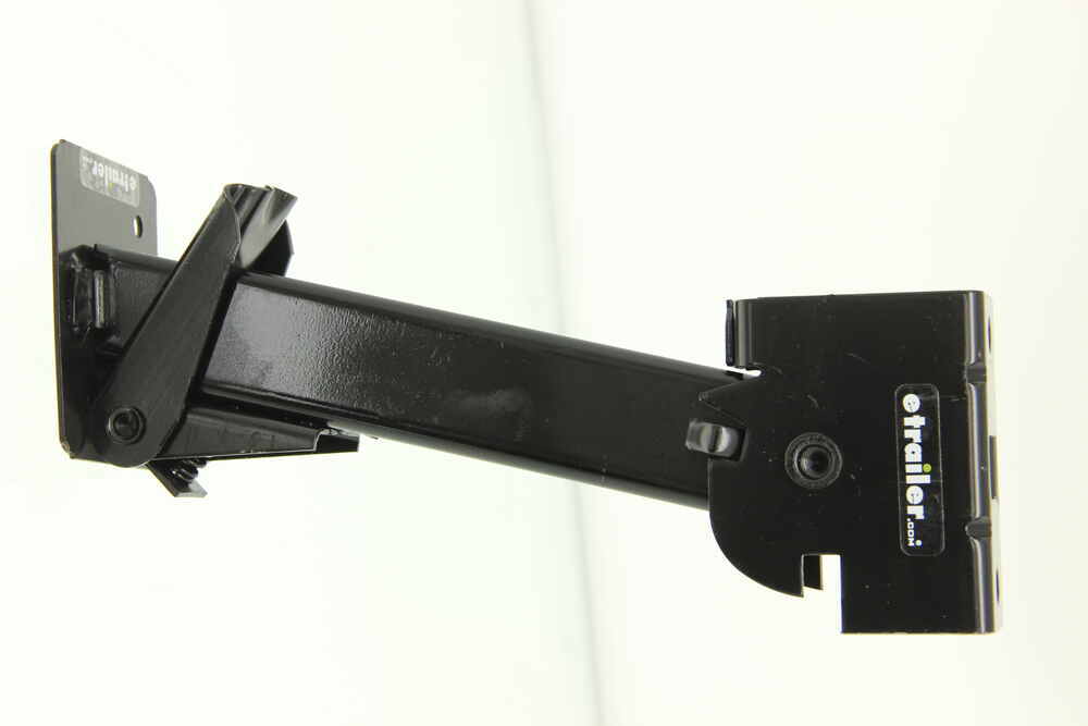

This crane is really over kill as far as the capacity for the back of the 1872, its what I use in the back of the truck so I didn't have to spend anything for this add on. I have some manual outriggers on order, I'm afraid to pick up much weight without them so I havnt done a real weight test yet. I'm thinking it will work out ok.https://www.etrailer.com/static/imag...301_5_1000.jpg I bolted this to a sleeve hitch receiver adapter from Johnny Products but it is done so it can be unbolted easily. As it is now I can still put the hitch in and hook up the trailer to load into it or use it as a tow hook to rescue a broken cub.
