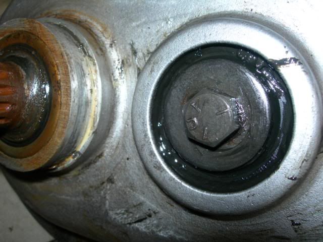

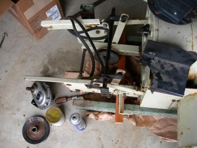

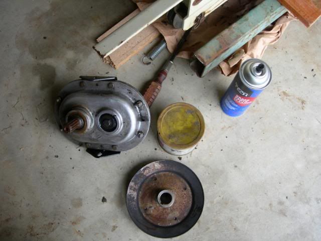

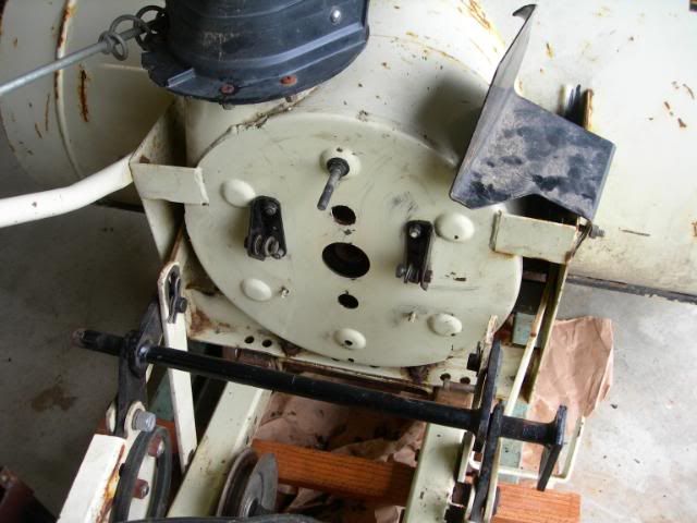

I took a close look at the 450 blower I picked up last weekend. I noticed a lot of grease on the main gear box, so I did a little cleaning and disassembly. Here's what I ended up with.
This is the leaky area. I checked out the parts diagram and it only shows a bearing cartridge a washer and the bolt, no seal. I guess I'll be digging in to the gear box. The front gear box is in great shape, and everything turns free and easy.

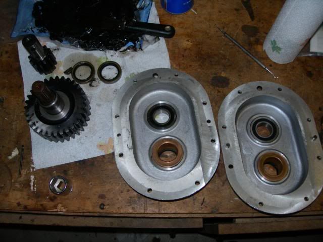

Got the gearbox disassembled, cleaned up, new bearings and seals installed and am picking up the necessary super secret and expensive lubricants necessary to put it all back together. (plastilube and some other grease for the other gearbox) I'll be straightening out the blades a bit and I think I'll clean up the rust and shoot a coat of paint on her for next year. Pics to follow.

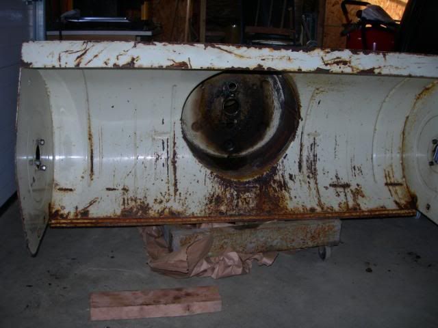

Here's a few pics.
Shell

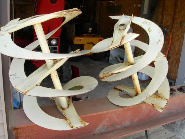

Blades - need a little straightening

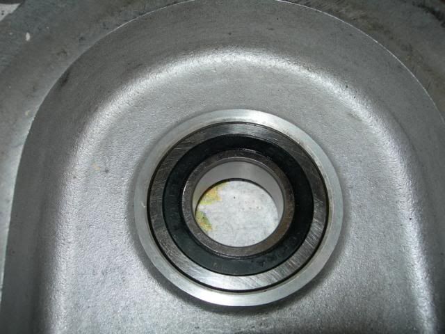

Gearbox halves all cleaned and ready for reassembly

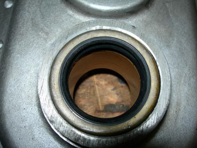

New Bearings and Seals to keep the grease (obviously with a gold addititive) from leaking out.

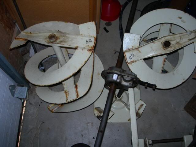

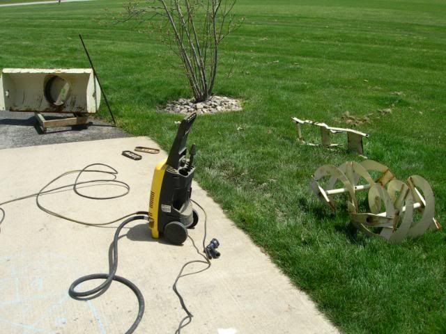

I spent some time Sunday pressure washing the main housing, cutting edge, skids, and blades. I also broke out the big hammer and I-beam to straighten the blades. They came out good, and now I need to go over everything with a wire wheel and grinder to get rid of the rust, shoot some primer and color. After I broke most of the carriage bolts that hold the cutting edge on, I ordered new hardware in stainless.

Blades straighened
