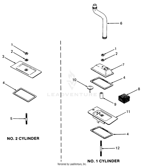

You can pull the breather covers off to see if the valves are moving. I had a M20 with a stuck valve and was able to free it from there.
https://cdn.datamanager.arinet.com/i...d1e83f3/Medium
