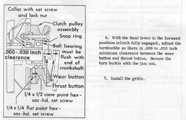

Can't seem to locate the right measurement for the plastic PTO wear button to the PTO. My 128's was totally missing last night and I have a new replacement wear button installed. Just need to know how much distance it needs to be. Any help? I don't need it now,but would like to have it done for tomorrows mowing..

Here you go:

Or the thickness of a matchbook cover...

Thank You very much,I know why I am a member of this website now again!!! Time to go set the gap and give it a try...
