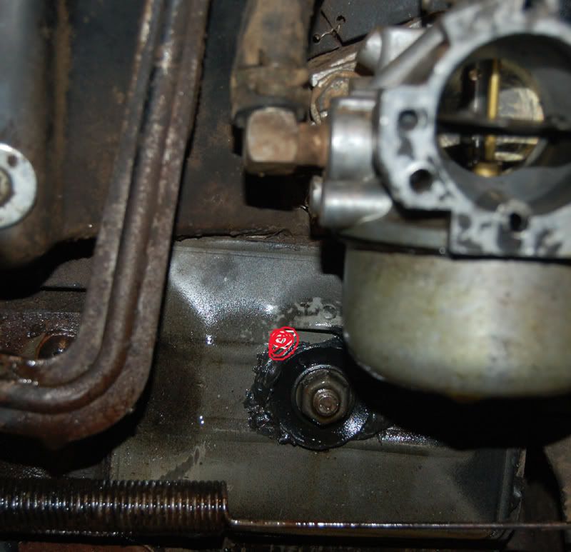

got the 1650 running...she runs really good, other than a mini oil gusher...she has not run in quite a few years...went through carb, points,condenser,timing..and she fired up...then she started squirting oil here..(see pic)...im a newb so wondering what the next step would be..i believe it was coming from the baffle above the dot, but might have been from the nut/bolt seal...

ok..so since the valves are behind here..crankcase pressure?...

ok,,,so i found this...
http://www.weekendfreedommachines.or.../17/33415.html
and after looking in the k341 book,,i dont see it?...so am i missing a breather assembly?

As found on page 12.17 in the Service Manual....
See link for Service Manual... Service Manual
