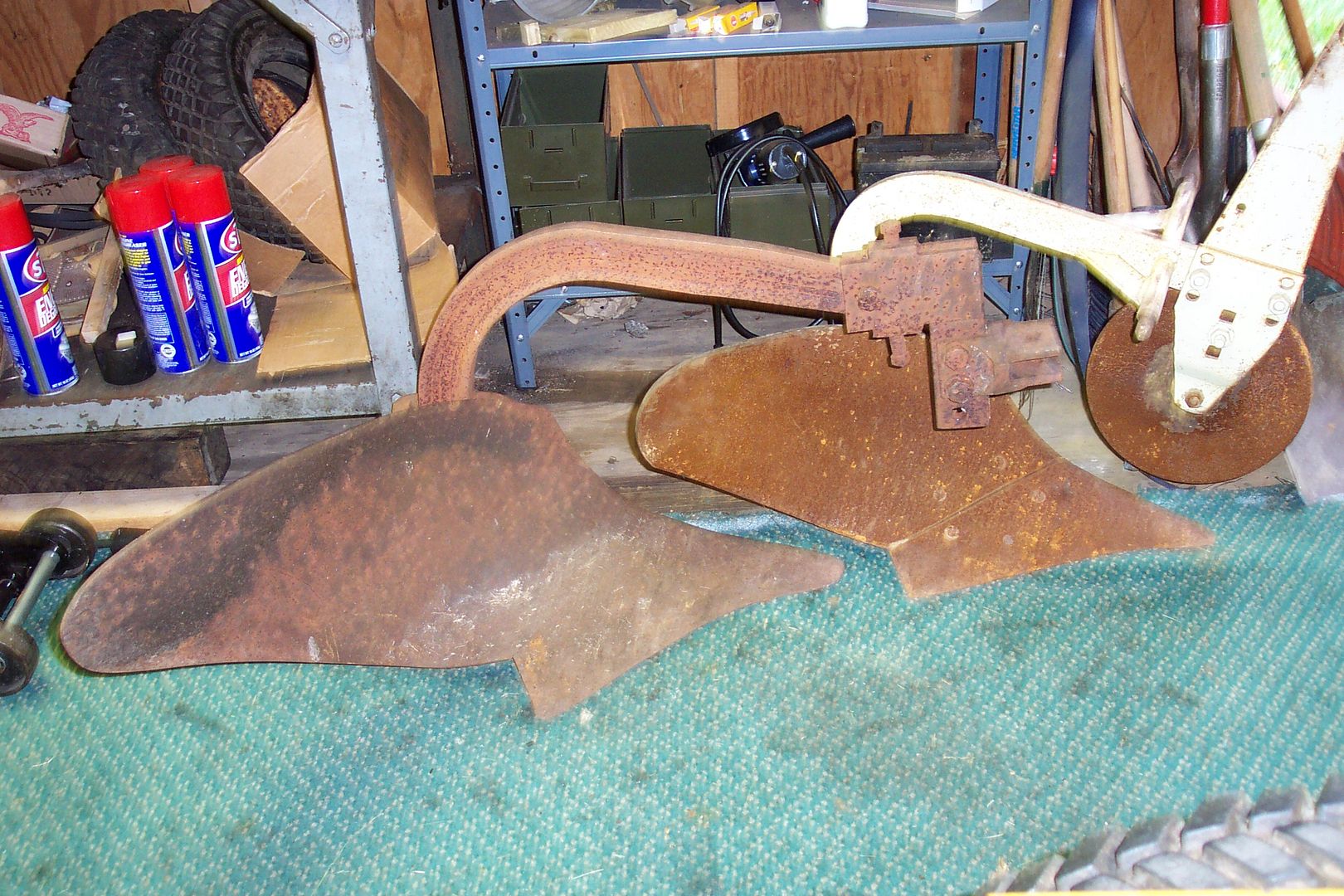

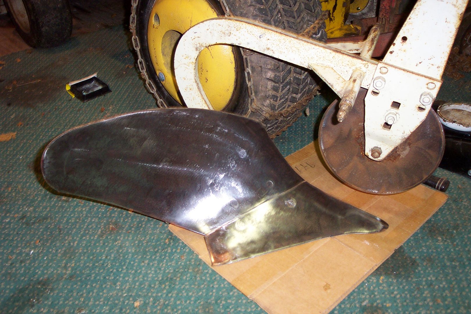

I used scotchbrite pads on a 4 1/2" grinder to polish up a plow. Worked pretty good. ( a rusty plow won't plow slowly until the dirt "polishes" it--it'll be all herky jerky )
Before ( on right )click for big
After about 5 minutes work
