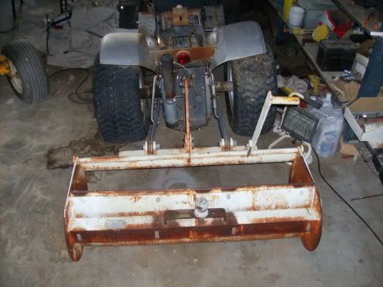

Hello guys,
I have an old,1978 or so,sears gt 16 riding mower,Im going to get back to good running order for a friend.
PROBLEM!!!
I have no idea where to get manuals for it.Sears perhaps??havent tryed there yet,but was wondering if anyone new of a source online.
It has a big old 16 horse briggs twin that will start,but is flooded at start up so it will sputter for a minite or so then come up to rpm.It will do this with the fule pump on or off at start up!!It has a aftermarket pump mounted with a seperate switch.
I have never had such a hard time finding out what type oil to put in the rear end,its a 3 speed stick with a high and low range,where to get seals,filters.....Ect
I love our old cubs,such a wealth of info at your finger tips!!
The mower belongs to a friend at church,I brought it home to fix it up for them,replace a couple seals,filters,oil ect and im having a tough time!!!I found a couple sears tractor forums but not much help there,they suggested ebay,but nothing there!!!
I love this fourm,so much willing help.
Here is a couple pics,I took awhile back.............................................. .
Thanks for any help jason

Thank you Ill try to find the ser. number,I dont know much about the old sears mowers,The tranny is the strongest ive seen in a mower,although it looks as its been forged of dirt and grease right now!!With that gannon earthcavator hanging out back id does great wheelies and keeps it from flipping over,LOL,Id like to find the owners a set of chains but im kinda torn about dumping a bunch of cash into something other than my cubs,maybe selfish,but honest!!!Im going to look into the engine today and see if i can get filters,points(if it has them) plugs and see what a carb rebuild kit costs.I am limited in knoledge on a twin briggs,or any twinn for that matter,or should I say even the singles aur cubs have in them,so there will be a learning curve here!!!I do need it as I have two kohlers sitting in the shop that Im gonna go through!!
