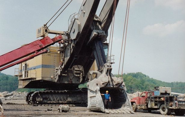

Old 03-17-2013, 12:21 PM
Posts: 3,503
Does anybody have any pictures they can post? I love pictures
I like pictures also!!
Here is a picture I took a few years back.

Old 03-17-2013, 01:45 PM
Posts: 3,503
I rode that shovel for four 8 hour days. The machine is all electric and pulls a 4,000 volt extension cord.
We were stopped when the pic was taken to replace the electric motor that powered the "stick" (the piece on the center of the boom that can extend or retract.)
The motor is on the ground under the crane.
Today, the machine costs about $20 million.
The tracks are over 6 1/2 feet high. Each pad of the tracks weighed as much as a small car.
This machine is (was?) located near Pikeville KY.
The machine ran 24-7. When it would "crowd the bank" to fill the bucket, it pulled so much electricity, at night you could see the lights dim at a service shop 1/4 mile away.
