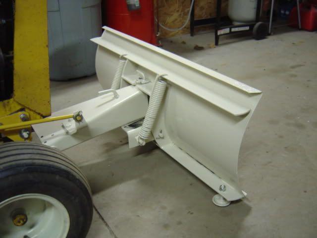

The older Cub blades were made to move dirt as well as snow. They can be locked down so that they don't trip.

How do you lock the blade in so that it doesn't trip? Any pics?

Any chance you guys have a picture of what a blade looks like on an 82 series tractor? Have always kicked around the idea of putting one on my 982, just wondering what they look like, what all I need to add to make it "fit" on at the front?

I have been using a CC push blade for years to push dirt. Just don't try and push the hole pile at one time. I have leveled truck loads of dirt in just a few minutes. The blade does not work well to get a flat surface. The blade tends to roller coster.
I have been using a narrow frame blade assembly on a 782 for years. It is a very simple fix to make it work.,

Can anyone add to Wildbill's pictures? More details of the linkage where it attaches to tractor in front and going to assume it is a clevis style that is wrapped around the rock shaft?? I notice alot of them the lift lever runs from the blade back to the rock shaft bracket which is above the running board (foot board). Do you flip that up or something or does it just depend on the tractor if it is above or below the running board? Mine is below now, that's why I am asking. Didn't know if it was enough travel for the lift arm to raise the blade up and down if it was below the running board?

MH, you need one of the Haban 54" blades for that 982. The blades for the regular GTs don't fit without mods. Anybody with a super got pictures for him?
