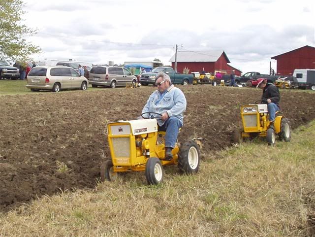

There are several pictures from different Plow Day events with 7hp s flipping sod with the biggest out there. Merk has a 70 that does a beautiful job plowing. Of course it doesn't hurt he knows what he's doing.:biggrin2.gif:

Here are two 70s both pulling 10 inch plows.
The first one is me. I was able to pull the plow 4 to 5 inches deep in 2nd gear. The rear wheels where spinning....need more weight on the rear tires(no fluid in tires). I had no wheel spinning in 1st gear.
A 7 horsepower motor will do a good job plowing. Don't expect to go to the races when you pull a plow.

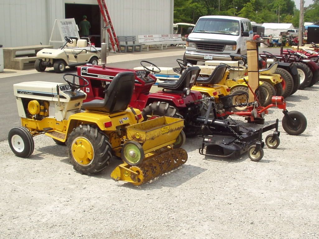

Here is the Viking Landscaper:

Sorry to bring up an extrememly old thread but google search showed me the pic lol! What is the red tractor to the right with the brush hog on it - that is just gorgeous! I appreciate anyone who could help identify it !
Old 10-01-2013, 03:43 PM
I recognize those pics. Red power roundup 2013, such a great few days. I agree on the plowing; it's meant to be slow, steady and thorough.
