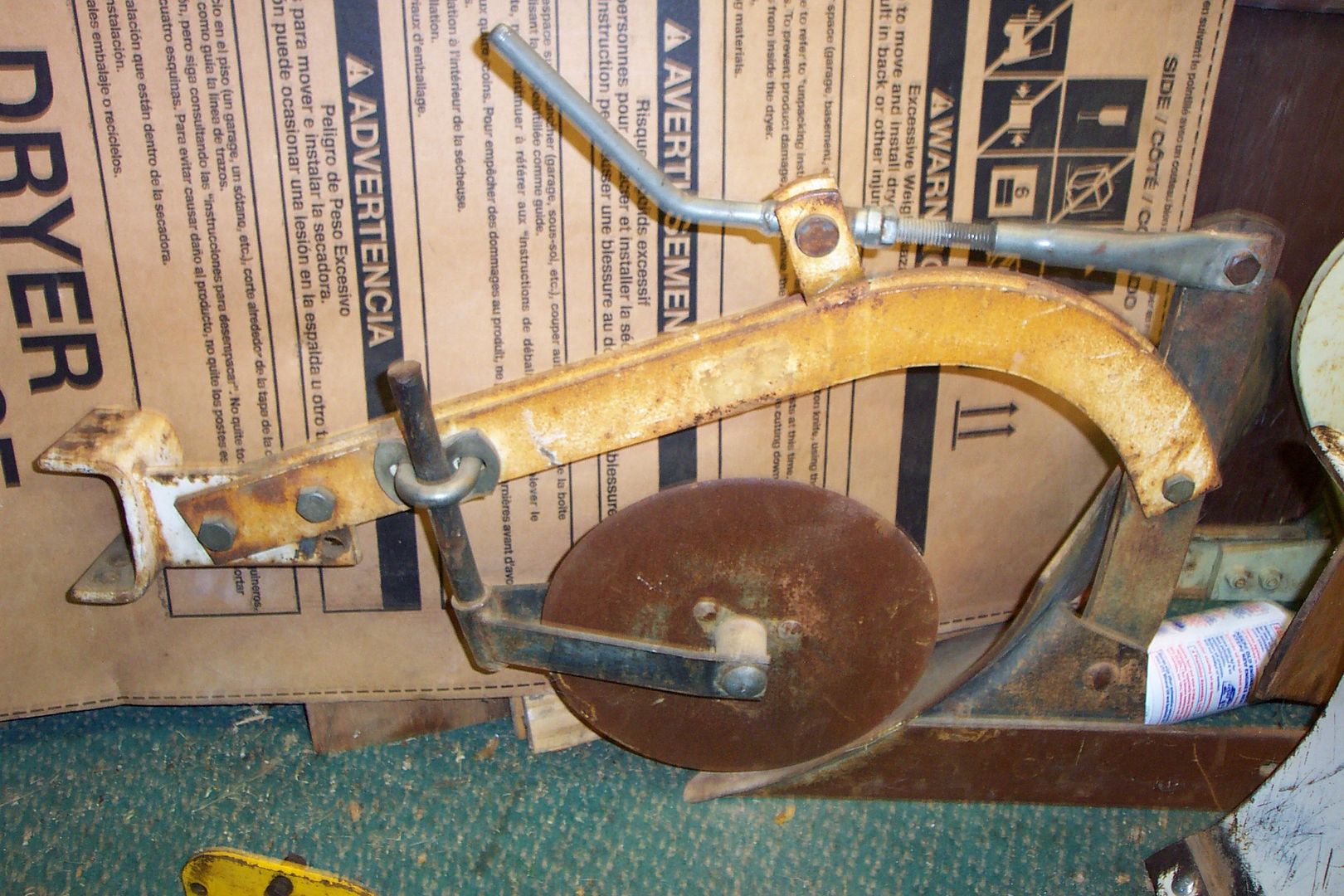

Sleeve hitch adapter
Lift pin that fits in the rear lift casting
Not sure if you need this for the rear casting pivot. If the holes are 7/8" you need "Frankenstein bolts". If they are 5/8", then a rod is what you use
Here is a picture of Narrow frame ( you have a wide frame and they will be slightly different ) rear lift parts plus a spring assist
click for bigger picture
This is the type of plow you want to get

Do you have a rear lift? ( the casting with lift bar that connects to the lift handle or hydraulic cylinder )
Can you post pictures of your 1200?
Old 01-05-2014, 02:26 PM
Similar to this
