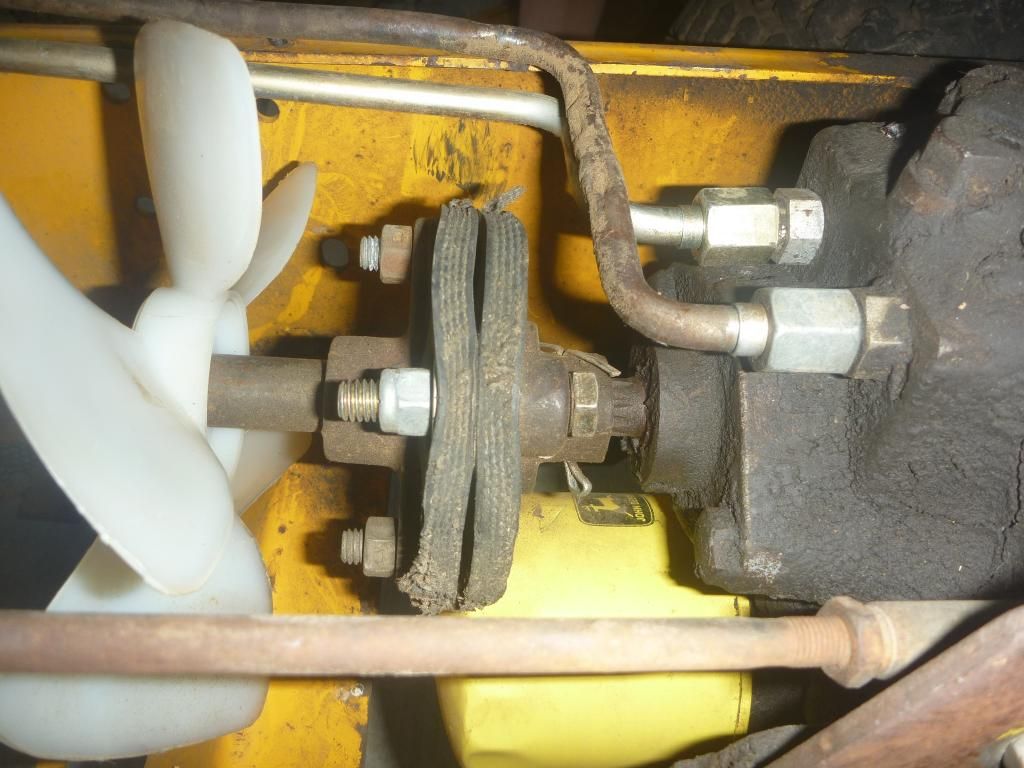

Since the shaft coming out of the pump is splined, taking all the strain, is the cotter pin the correct fastener in this location?
Notice the 2 nylon lock nuts barely hand tight on the driveshaft coupler. Keep in mind, the shop said all repairs were "complete."

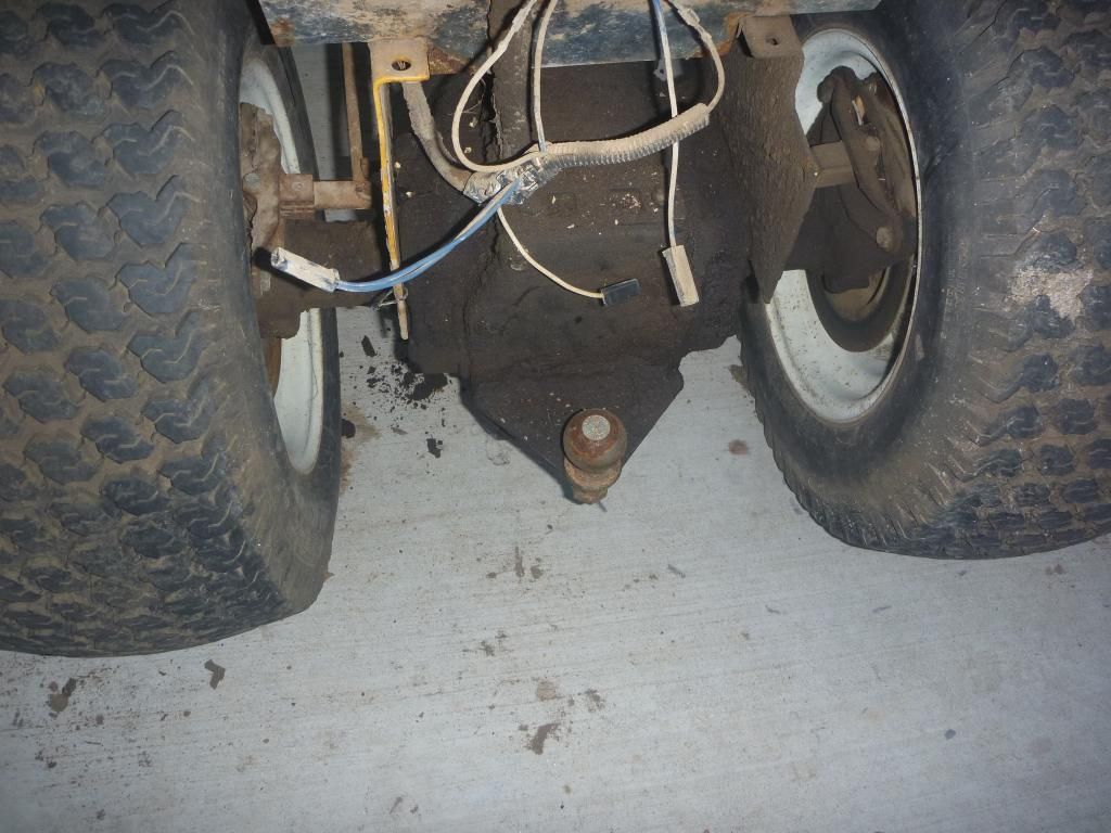

I don't think this tractor has ever been even rinsed off. The crud on the rear end is about 1/4 to 1/2" deep everywhere.

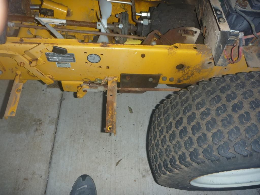

Can someone tell me what these brackets would be for?

Cotterpin should be a Roll pin or spiral pin. That is bound to cause shaft and/or pump problems

The Brown bracket is an anchor plate that some attachments use on the supers. Haban 60 in deck and 54 inch blade are a few.

That makes sense. I sold the subframe off of it, because I didn't have the deck. I was told the subframe was for the haban 60". So I can take those off since I will be putting a 50" deck on it. How's your 1872 treating you timbo?

2nd take a good look at the transmission mounts I see loose axle tube bolts in your pic.
3rd drive shaft needs some TLC
I posted a sticky with a few threads you may want to check out, it's called Cyclops repairs but the rear ends are the same in the 1872's
