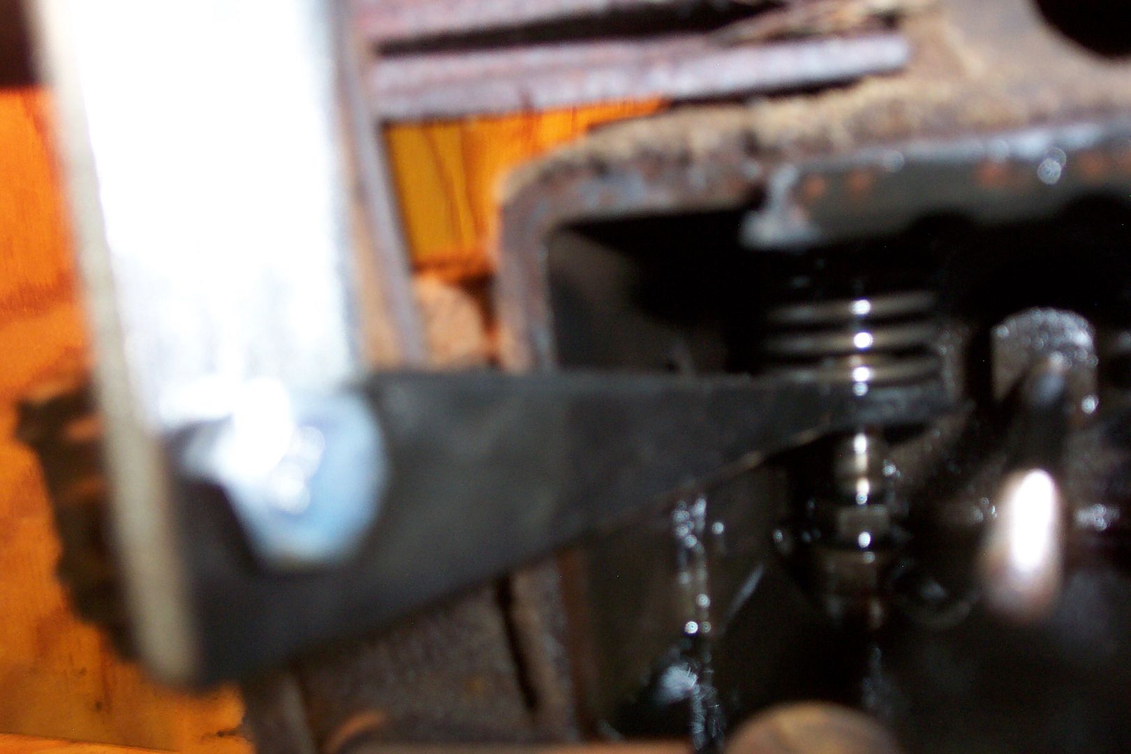

No video but pictures, I'll post thumbnail sized pics, click for larger views.
The valve assembly consists of the valve, a spring, a retainer ( washer ) and two tapered keepers.
Compress the valve assembly
Then you remove the two keepers ( they may spin around the valve stem )
( sorry not very clear )
Unscrew the valve compressor and remove all components.

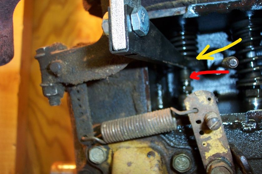

Thank you for the reply! Do the keepers just slide off the end of the stem, or do they some how come off the side of the stem?
After the spring is compressed, I see a round piece with a notch in it, a large washer type deal, and then another thicker round piece with a notch in it...
Old 08-10-2014, 10:23 PM
The valve stem has a notch for the keepers ( two halves slide into the valve spring retainer ). They may slide around the valve stem and stay attached due to the oil film on them.
Red arrow is the keepers, yellow arrow is the spring retainer

Got them taken off, thank you Jeff!!
