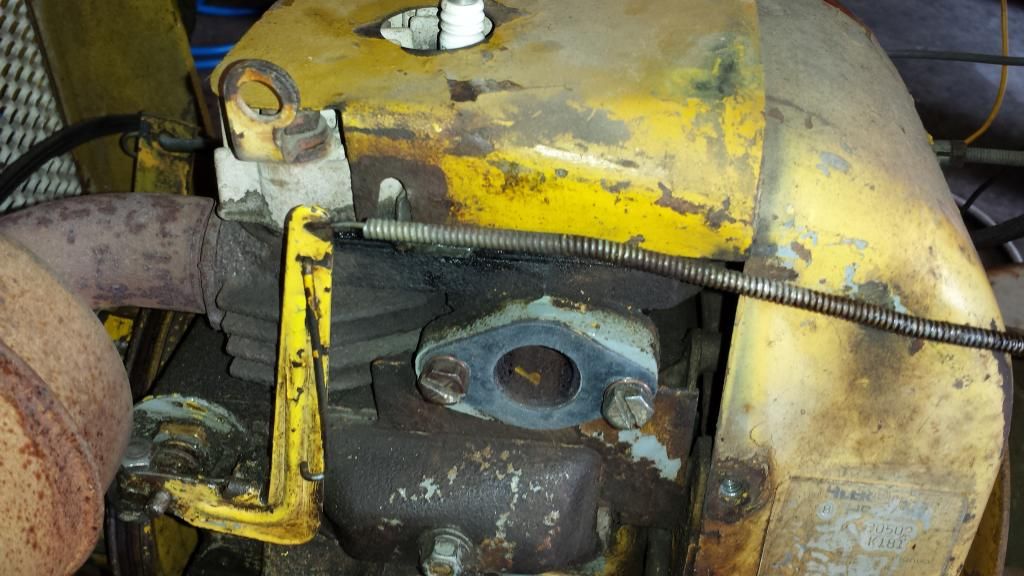

yeah the list of PO mods is pretty long on this one, some to be expected since its a replacement engine but some of this I don't quite understand.
It did start and run though.
Check out this throttle/Gov setup. no linkage, no spring.
It's on the list, pacing myself.
- Tim
I wish I had thought of that setup when I was a kid. Much more reliable than string. Young and dumb
