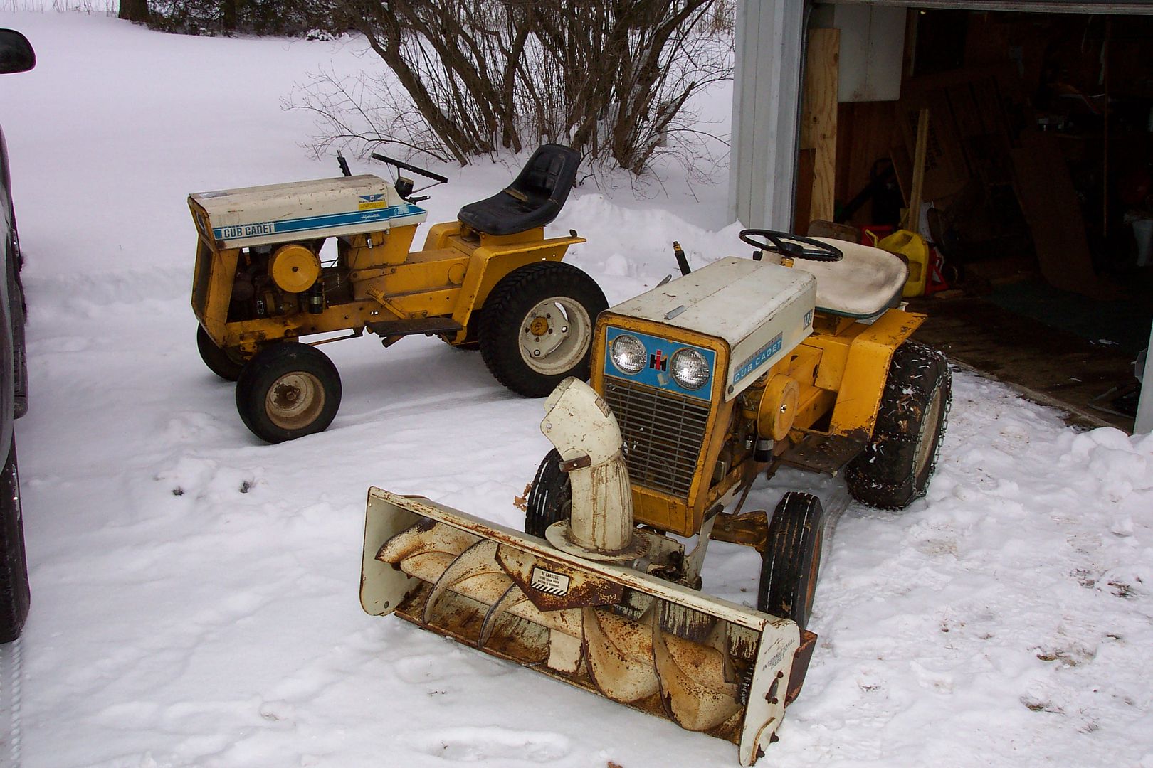

It will work. NF attachments fit NF's.
Now, there are QA (quick attach) attachments, and bolt on. Tractors with QA brackets can use the bolt on stuff too, but tractors without the QA brackets cannot use QA attachments. The QA came out in the 1X4/5 series.
Click on the picture of my 122 with my QA-42 snow thrower on it.
I just used my QA straps and bolted it right up.
Here's my 125 with an early dirt blade bolted up
Nobody told me it wasn't supposed to work
