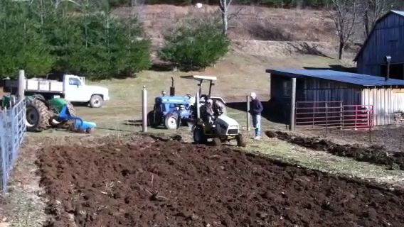

I think you would be fine, I run mine all day at plow day and I've had zero issues. Here's a quick video of the 1782 pulling a 12" brinly. ( just click on the pic)
