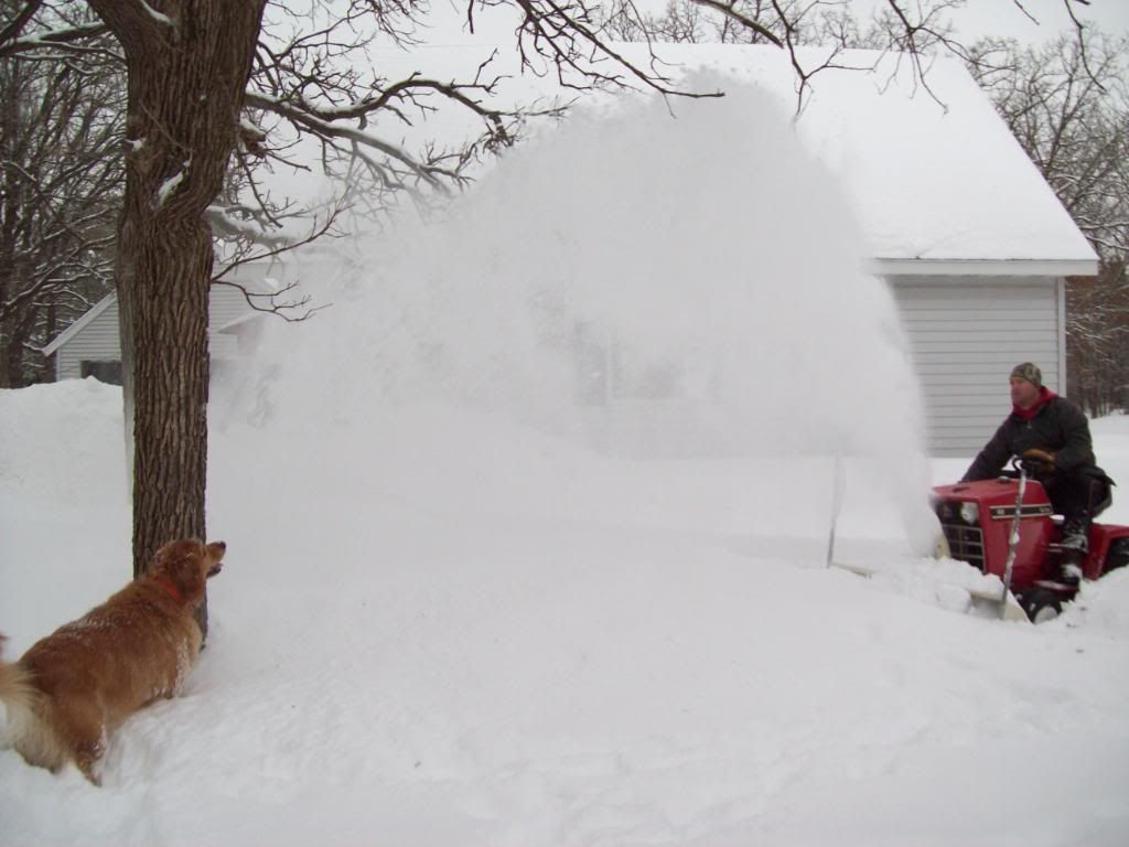

I have a QA42A snowthrower and it only throws the snow about 6 feet out in any direction. Some of the pictures I have seen have others throwing snow about 15 feet out. My thrower also plugs up easily and I have ez-slide in the chute. Are these two problems related? The thrower is mounted on a 129 with the stock engine. Any suggestions on what could be wrong? Pictures of the thrower are posted in the: help identify my snow thrower thread. Thanks

Are you running at wide-open throttle, as is the engine speed set properly?
You have to vary your groundspeed such that thrower is full and the engine is just tugging on the governor.

My QA42A will throw the snow as far as WildBill's does. Mine is on my 169 and that 16 horse really barks if the snow is deep. Great thing about a hydro, pull the lever back till you're through the deep stuff then speed up. I don't have any slip plate or such in my thrower or chute. I agree with the others, really depends on the type of snow you're moving.

Fluffy/dryer snow throws real good..
Wetter stuff is less than half of in the pics
