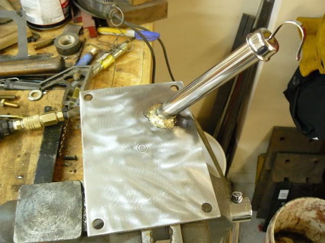

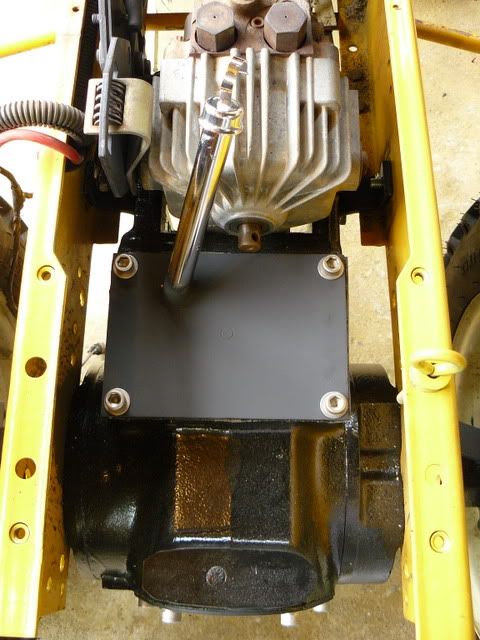

Something else you can add to your CI rear and not have to contend with that useless dip stick/filler tube on the aluminum rears.
