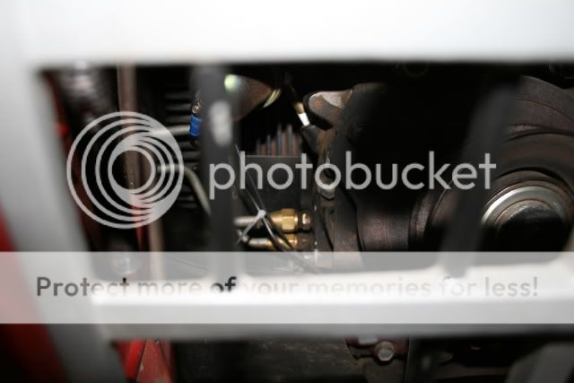

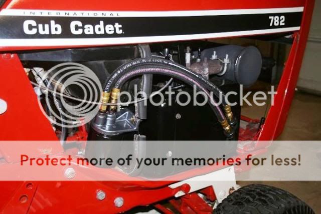

If you look at my picture and follow where the two lines hook to the engine, that's where you would have an oil filter adapter block-off plate installed with two allenhead bolts. If it has this, it's definitely a series II. But like Keith said, some of the early series II didn't have this.

here's a better picture for you
