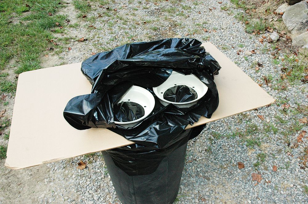

ANY oil based paint will do that, if you do not get the volatiles out correctly.
Painting when it is cold, or humid is bad,,, I like to paint when I can leave it in the sun for a few hours.
One time, I reverted to a trash bag to "solar collect" some heat, that worked real good!!
