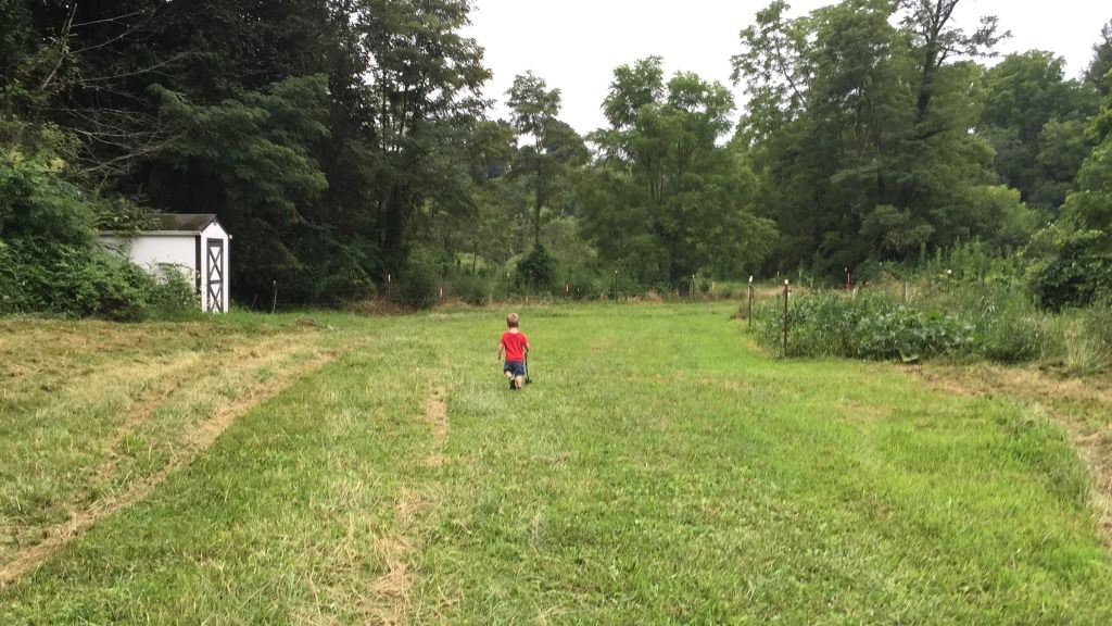

I'll put a photo of the main garden area below. I would say it's about an acre in this area. We have plans to do another 2-3 garden plots on the land elsewhere. They will be on sloping land. The main garden space is bordered by a creek that flows about 4' below the grade of this land. We did some small scale gardening (see photo) this summer and lost some seeds due to heavy rain and flooding/washing-out of the beds. That (plus the plan for potatoes) is why I want to raise up the planting beds some, which is semi-naturally done when using a tractor for gardening--the tires compress the non-planting areas as you drive. Hauling in dirt for raising the land is not an option.
