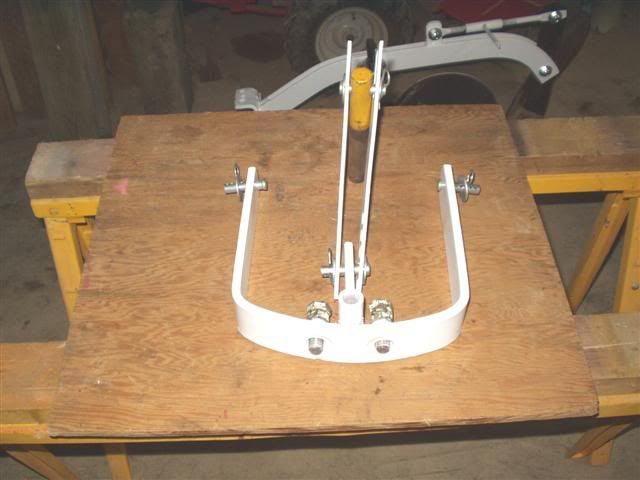

Here's the best I've got for a picture. That piece you are talking about is the lower 3-point bracket, and is part of the IH 3-point hitch assembly.
Oops, that picture is just the 3-point with no sleeve hitch adapter. The sleeve hitch adapter consists of the U-shaped piece of metal, 2 clevis pins to attach it to the 3-point lower bracket, either lift straps (OEM) or chains (what I typically use) to connect the sleeve hitch adapter to the upper cast-iron part of the 3-point hitch, as well as a couple more clevis pins for the straps/chains. You'll also need a 5/8" hitch pin to connect the implements, and I'm sure some people will say you need a draft plate (someone must have a picture) but I never use one.

Once again, thank you. I have none of these parts on my tractor. It almost sounds like I need a 3 pt hitch set up for my Cub? And then some type of linkage to go to my hydraulics to raise and lower.

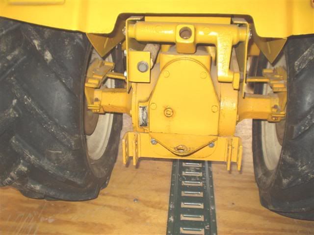

Wide Frame hitch:
Narrow frame hitch
(white part is draft plate):

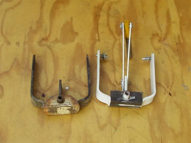

Sleeve Hitch adapter:
There are 2 more different styles sleeve hitch adapters that Brinly made. I have both. Will try to get pictures of them.

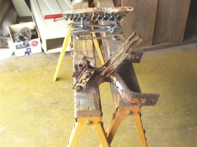

Last version:
First style-used on Original Cubs:

Thank you very much. I can finally see what everyone's been talking about. Unfortunately, I have absolutely none of these parts. But now I know what to look for. I understood the sleeve hitch adapter, but was confused on the "yellow" parts bolted right on the tractor. What are they called as far as looking and ordering?
Old 11-20-2009, 09:33 AM
Those parts are the 3-point hitch.

Thanks Matt. I've been looking for a 3 pt hitch. All the ones I see advertised are never for a 122. What other model Cubs are compatable with a 122?

Any 3-point meant for a narrowframe will work.
