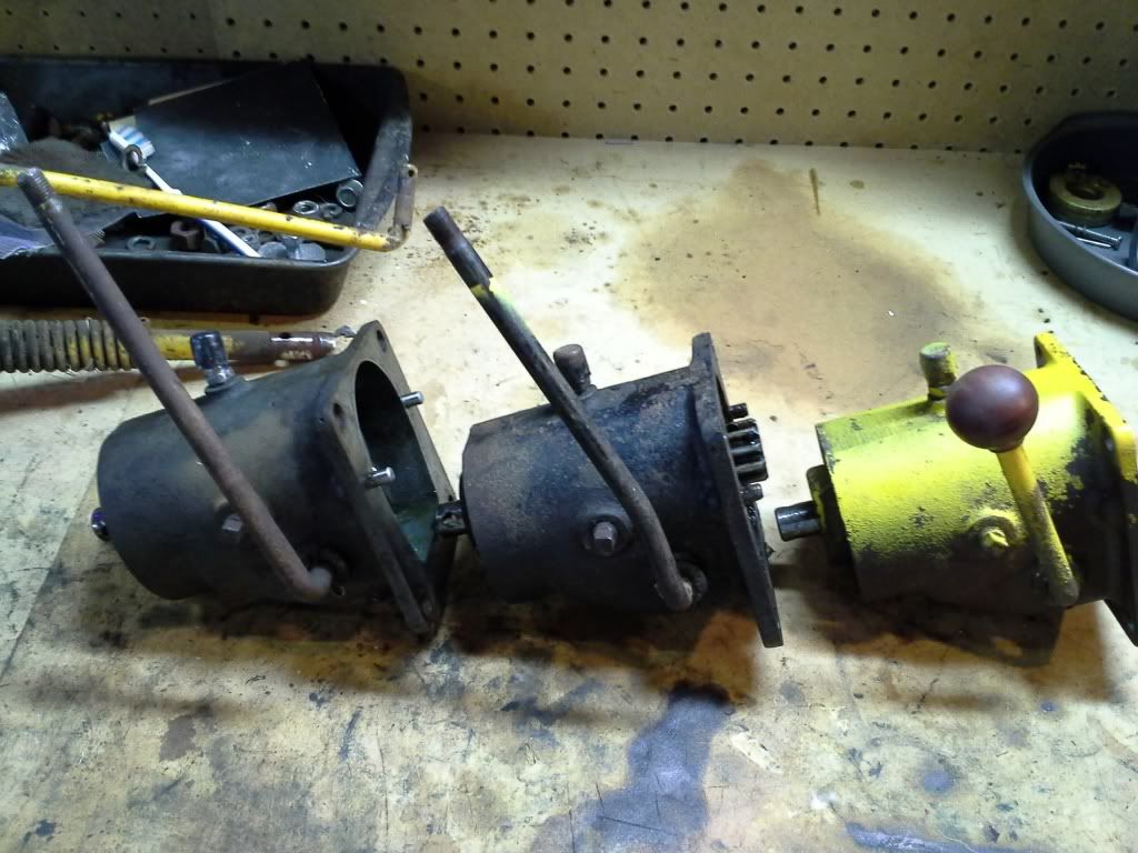

Ive researched until Im blue in the face on the net. I know there are 2 separate handles for creepers. One for wide frame and one for narrow. Now one place says the wide frame is longer both horizontal and vertical. How many factory handles are there? I have these 3 creepers which I thought two are wides and 1 is narrow but they dont fit what Im reading. I want to list them for sale but I dont want to list incorrectly so what do I have??? Thanks Don

I think you have two wide frames, and a narrow frame. Looks like one of the levers just got bent. However, upon researching parts books, I did find 3 different part numbers for creeper handles. One part number on the narrow frames. It changed to a different number on a wideframe, and again in the 82 series.

i agree with jonathan, and wow 3 creepers

That makes sense because one is out of a 1200, one is out of a 582 and the other was in a 1000 with and extension. I just wanted other set of eyes to tell me I was seeing what I thought I was. Thanks Guys!
