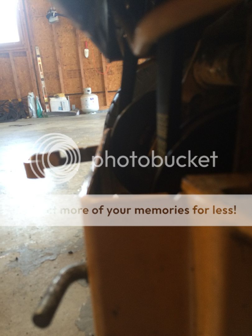

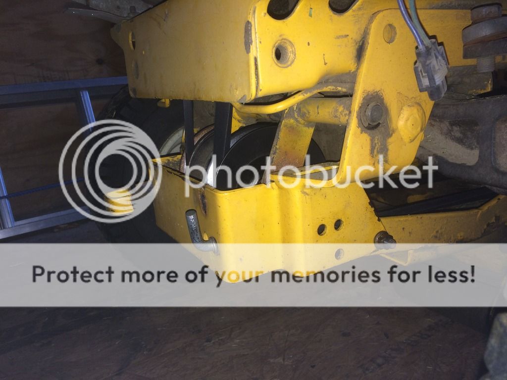

I'm back with a question about my 2082 with the 54" GT deck and I need another nudge in the right direction. Last time I mowed I ended up having to stop halfway through and do some work on the belt tensioner on the deck. It wouldn't hold tension on the deck belt, so I cleaned up the spring with some PB blaster and compressed air and it seemed to free everything up so I could get the yard done. While I had the deck out I did grease the tensioner. When I was putting everything back together I noticed the PTO drive belt was way out of adjustment as per the 324 deck manual I've got. I picked up a brand new belt from the local dealer and yesterday I installed the new belt and tried adjusting everything again, and I can't get it adjusted the way the manual wants.
If I adjust the adjustment arm in, so the pulley and belt ride lined up with the V notch in the frame (Right side as your looking from the front), the left side is way off (has the spring loaded arm with a notch to hold the pulley back). If I adjust the arm out, and pull the spring loaded side back in so the V notch on that side is positioned correctly, the adjustment arm side pulley rides way forward of it's V notch and almost touches the front of the frame. I've included a couple pictures as I'm sure you guys can't picture what I'm saying from my babbling.

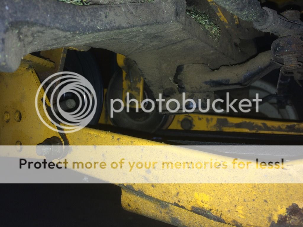

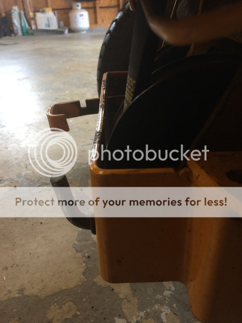

Do these two help you Sam??

Yep they sure do. Just my 2 cents but I would get a shorter belt. If you have a TSC near you take your old belt and match it up then get a couple shorter belts, keep the one that fits the best and return the others.
Thought maybe you had the sub frame mounted in the wrong holes but your good.
