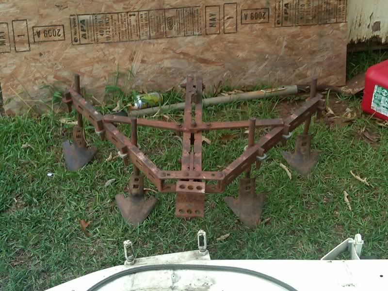

Allen We need a pic of what your talking about to make sure.

nice cultivator .....
Old 09-10-2011, 12:01 AM
I agree! Love to see it in action.
