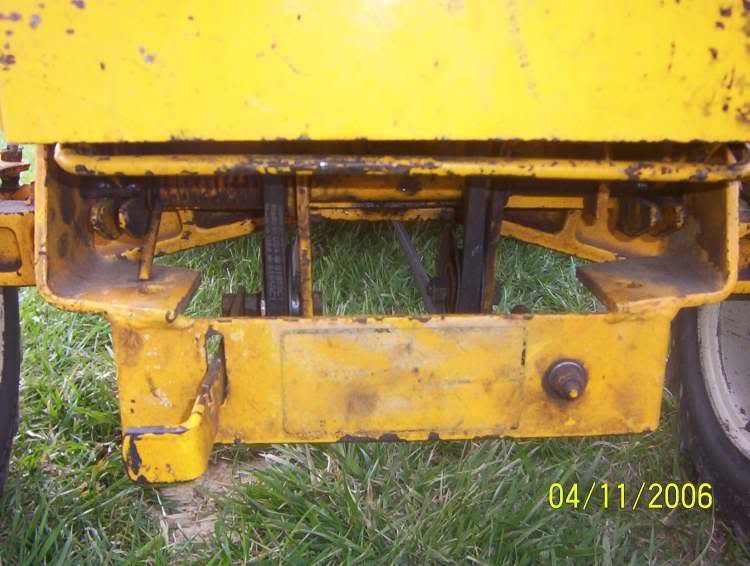

I took an extra A series deck mule drive, straightened the pulley arms, and have been using it on my 1450 for the last 8 years...with the same IH made tiller belt, with NO problems.
'straightened arms'
