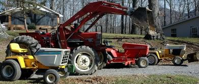

The cub manual states HY-Tran B-6 which is listed
That is all I use, 20 years, no problems so far!!
Oh, yea, besides Cubs I use it in this.
And these
except for the Gravely, it uses ATF and engine oil!!
