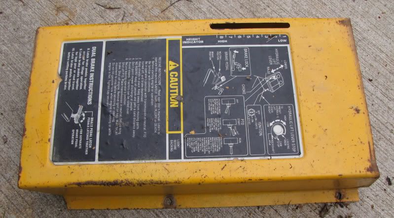

Looks like I need to level the deck just a little. This tractor does not have any kind of mowing height indication that is a real pain as you can't judge how high or low you are setting the mowing height.

Gonna try and level it out tonight by raising the rear deck hangers. I want it to be as high as possible because like I said above, there is no good way to set the cutting height consistently on this so I am going to have to come up with a way.

Got it all squared away tonight. Lowered the front hangers ONLY and it leveled right out and cuts much better...........of course. When I put something on the post about the rear hangers, I was actually referring to the threaded middle hanger and only one side is somewhat adjustable, but all of that looks just fine and I didn't mess with it at all.
Also, thanks to Madddog for pointing out the obvious on the adjustment knob. Worked with that and figured out how to adjust the cutting height on this beast. Need to research and see if there is a label that is supposed to go on there. A stamped plate would be much better though.

How do you like the Gators? I put a set on mine and absolutly love them.
As far as the height indicator, aren't the 982s like the 2072s? My 2072 had a pin that stuck up through a slot in the tunnel cover to indicate where the lift was.
