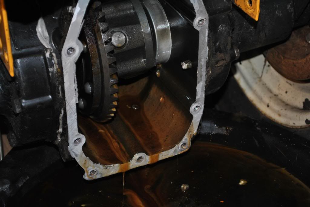

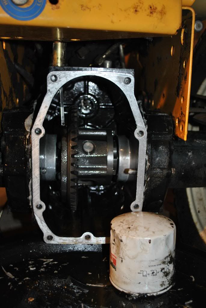

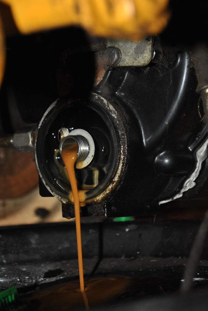

Just an update. While I'm working on getting a new line I drained out the Hydro Fluid and figured I'd share some of the photos.
This is the sludge that came out looking like caramel. No clue what fluid they had in there.
This is how the rear looked before I cleaned it out. Plenty of sludge and gasket sealer from the last time this was opened apparently.
All cleaned up!
Going to let it drain at least overnight and get the cover back on.
Old 11-11-2012, 08:15 PM
Sam Mac Sam Mac is online now
Posts: 18,857
Good man. Re-fill it like I told you and run it for a few hours and do it again and then put the good stuff in unless you are like me and plan on changing it every year. The Hy-Tran is awesome at holdin water. If you change it one a year it is a waste of $$$.
